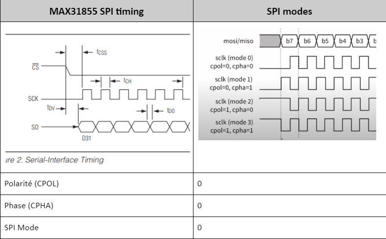

2) SPI mode
Regarding the MAX chronogram, I think that the right mode is 0.

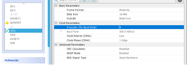

0693W00000Y7TG3QAN.png3) Configuration file IOC
Data Size is limited to 16 bits but the MAX sends 32bits. Is it ok if I use twice HAL_SPI_Receive_DMA() ?
(Full code is available at point 4)
uint8_t pData1[2] = {0};
uint8_t pData2[2] = {0};
HAL_SPI_Receive_DMA(hspi, pData1, 2);
HAL_SPI_Receive_DMA(hspi, pData2, 2);
SCK Rise and Fall time is 200ns. so I made this operation to find the baud rate :
Baud Rate = 1 bit / SCK Rise and Fall time = 1/(200 x 10^-9) = 5 x 10^-6 = 5Mbits/s
In IOC file, the maximum baud rate (Prescaler = 2) is 2Mbits/s which is not enough.
How can I set a good baud rate?
DMA configuration :

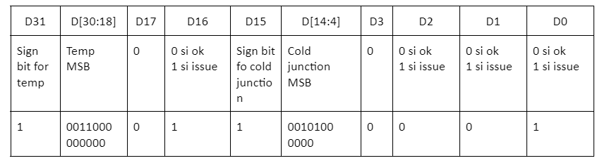

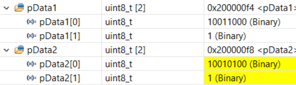

 I forgot to show the data output :
Here is the data mapping :
