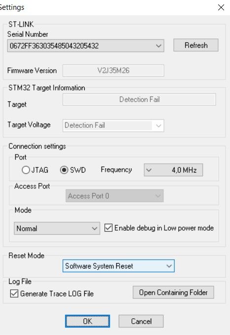

Thank you very much. I must have overlooked the user manual on that address.
After reading the manual I managed to connect to the nucleo board with STLink and started the debugger.
I have Keil uvision5 installed and I was able to debug the Blinky project. However when I started stepping over suddenly it crashed and I got disconnected from board.
Then I installed STLink Utility . I can`t connect using that either. I can the STLink version number but STM32 Target shows `Detection failed` . Target Voltage `Detection fail`
Jp1 1-2 is fitted and I got 2 red LEDs on .
Do you have any idea what might have gone ?
