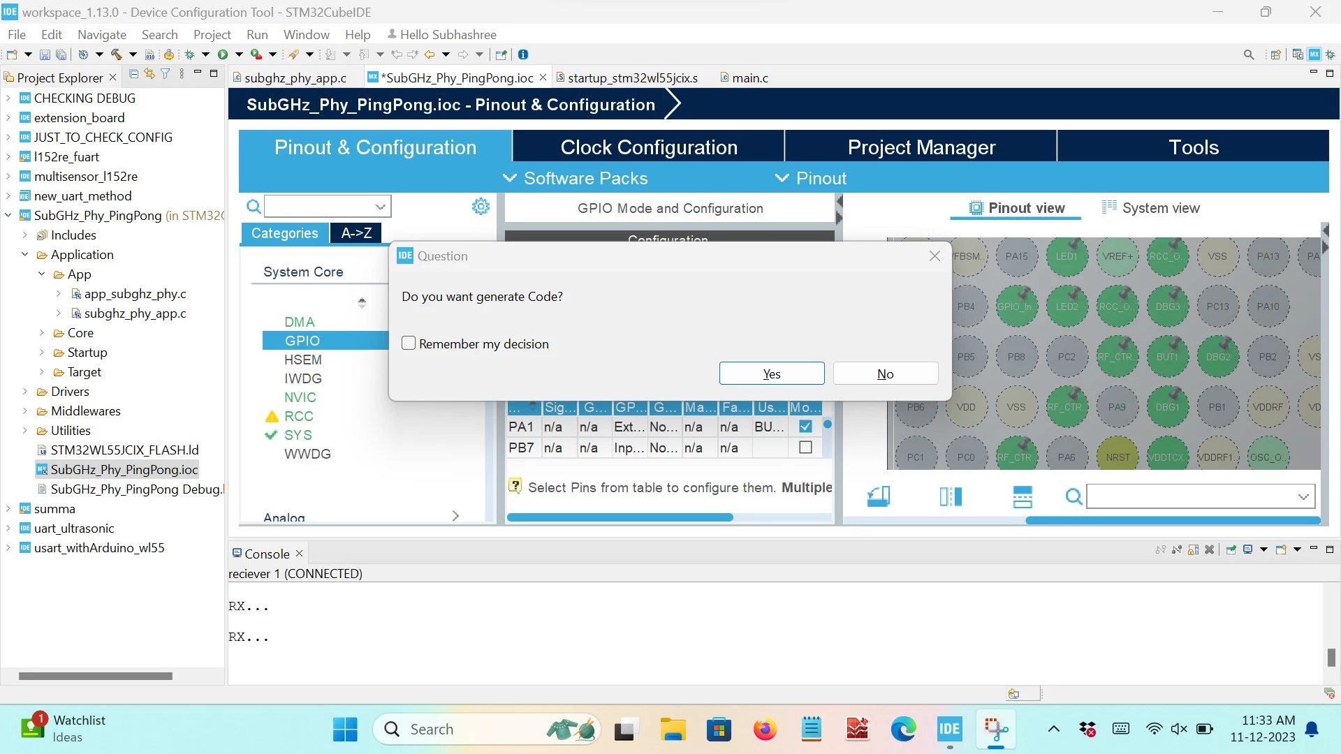

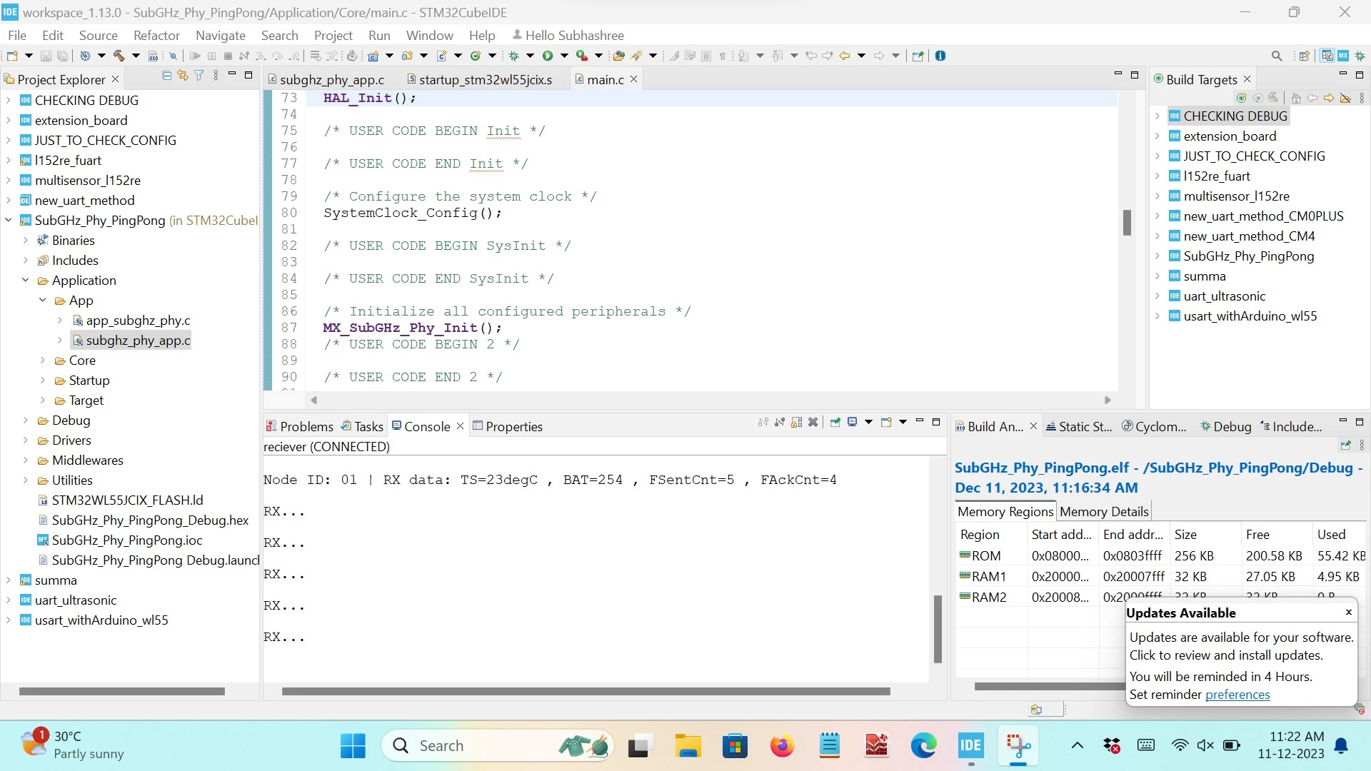

 Though, I was able to run the point-to-point communication using the SubG_Phy ping-pong example using the STM32CubeIDE programmer with the STM32WL55JC1 board.

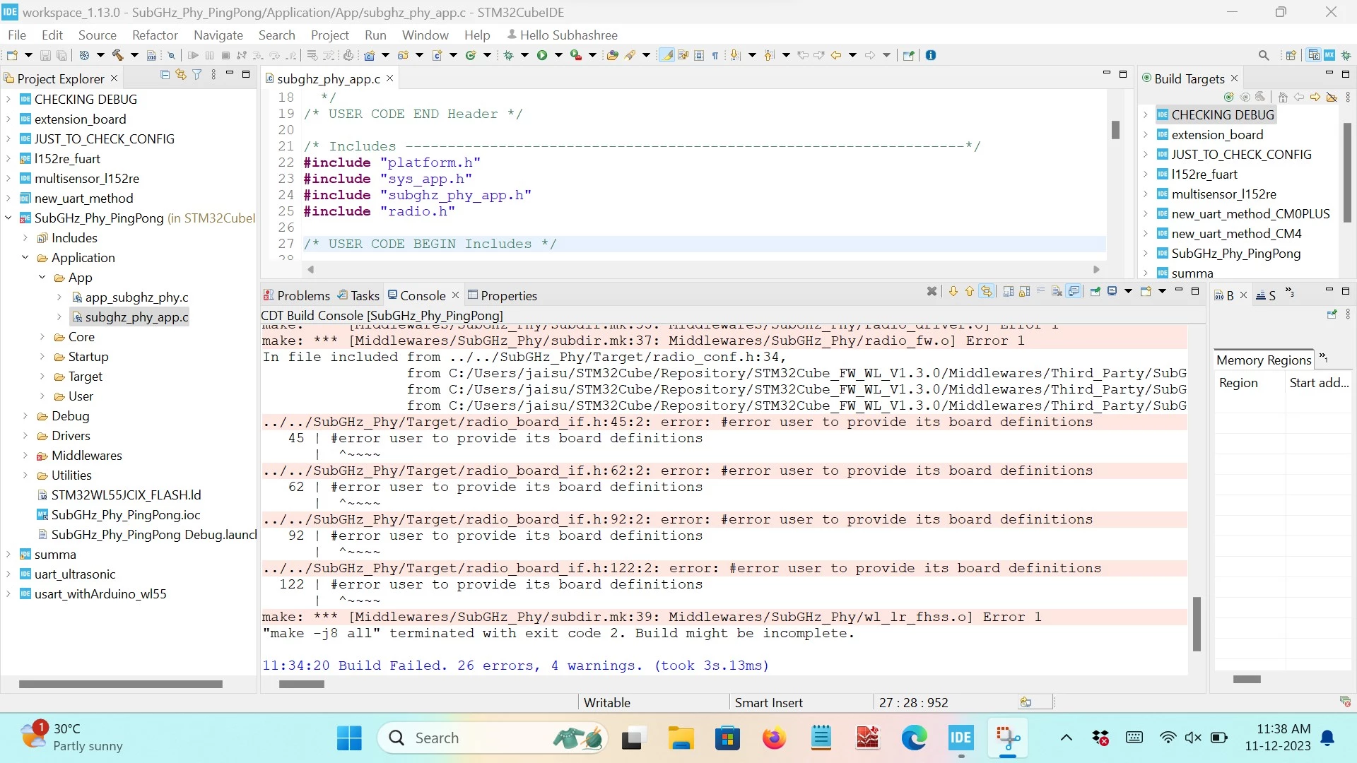

However, if I just enable a GPIO port (making any minor changes in the configuration) to the same SubG_Phy ping pong example, the whole code is regenerated to include the configuration changes to the code and it produces a lot of errors stating that "User to provide its board definitions". Only by just enabling a single GPIO port \ I am getting these many errors.
I tried many debugging tips like resetting, deleting the debug folder before running the program, restarting the whole project and IDE like for other projects, and replacing the radio. c and radio_driver.c files in the Middleware folder (as the errors were from these files) with the original radio.c and radio_driver.c files (before the changes). I tried my best to remove the errors and to run the program again, as the end goal is to successfully transmit sensor data with the LoRa communication protocol.  Can anyone suggest me a solution to debug this error?

December 25, 2023
   Thank you for the reply I am using only the STM32CubeIDE software (As the configuration can also be done through this IDE) and using the "STM32 Project from existing CubeIDE configuration file(.ioc)" option to run the example program. It runs fine but on making some changes to the configuration lot of errors are produced. Also installing the STM32CubeMX and STM32WL software is necessary to successfully run the program?
