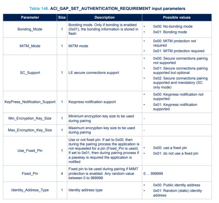

I found some details in AN5270.
So now I know what the settings mean but still can't require the use of a pin to connect.

I still do not seem to be able to get the STM32WB55 into a pairing mode. Here is a snippet of my code:
   * Initialize authentication
  BleApplicationContext.BleApplicationContext_legacy.bleSecurityParam.mitm_mode = CFG_MITM_PROTECTION;
  BleApplicationContext.BleApplicationContext_legacy.bleSecurityParam.OOB_Data_Present = 0;
  BleApplicationContext.BleApplicationContext_legacy.bleSecurityParam.encryptionKeySizeMin = 8;
  BleApplicationContext.BleApplicationContext_legacy.bleSecurityParam.encryptionKeySizeMax = 16;
  BleApplicationContext.BleApplicationContext_legacy.bleSecurityParam.Use_Fixed_Pin = 0;
  BleApplicationContext.BleApplicationContext_legacy.bleSecurityParam.Fixed_Pin = 111111;
  BleApplicationContext.BleApplicationContext_legacy.bleSecurityParam.bonding_mode = 1;
  for (index = 0; index < 16; index++)
    BleApplicationContext.BleApplicationContext_legacy.bleSecurityParam.OOB_Data[index] = (uint8_t) index;
  ret = aci_gap_set_authentication_requirement(BleApplicationContext.BleApplicationContext_legacy.bleSecurityParam.bonding_mode,
                                         BleApplicationContext.BleApplicationContext_legacy.bleSecurityParam.mitm_mode,
                                         1,
                                         0,
                                         BleApplicationContext.BleApplicationContext_legacy.bleSecurityParam.encryptionKeySizeMin,
                                         BleApplicationContext.BleApplicationContext_legacy.bleSecurityParam.encryptionKeySizeMax,
                                         BleApplicationContext.BleApplicationContext_legacy.bleSecurityParam.Use_Fixed_Pin,
                                         BleApplicationContext.BleApplicationContext_legacy.bleSecurityParam.Fixed_Pin,
                                         0
  if (ret != BLE_STATUS_SUCCESS)
     Error_Handler();
Bonding mode is set to 1 to enable bonding mode.
Use_Fixed_Pin is set to 0 to use a fixed pin.
MITM is set to 1 to require MITM protection.
Is there anything else that needs to be done to require the use of a fixed pin for bonding?
No matter what I do I seem to be stuck in the just works mode and my scanning software can connect with using a fixed pin.
Thanks for any help.
Here's a PDF (STM32WB_Pairing.pdf) that I got from STM that has helped with this question.
