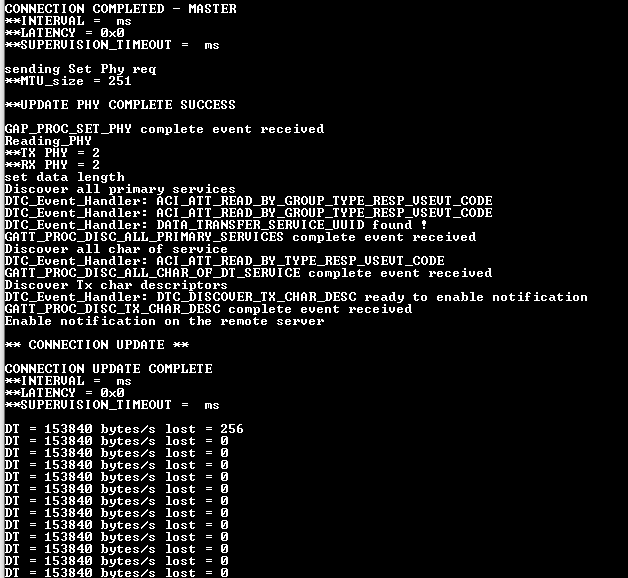

When I tried the example back in February I managed to get a throughput of 171 kBytes/s (close to theoretical maximum). I have since tried to recreate the performance with a custom service, though without any luck as my throughput is limited to 47 kBytes/s. So I tried to go back to the data throughput example to see what I did differently.
Going back to the data throughput example I can now reach a maximum of 153 kBytes/s with the following settings.
In app_conf.h
#define CFG_TX_PHY  2
#define CFG_RX_PHY  2
In app_ble.c -> Connection_Update(void)
I changed the CONN_P1_400 and CONN_P2_400 to CONN_P2_50 and CONN_P2_50. I know data throughput should be best at 400 ms but I got better results this way.
And most importantly I build the project with release setting instead of debug, in CubeIDE. This increased both the throughput and stability of the connection.

This is the output I receive from the dongle
0693W000008zUFFQA2.png/Robert

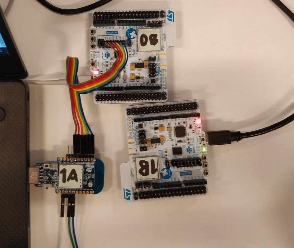

I don't think there is anything wrong with using 2 separate Nucleo boards, but I haven't tested that.
Soldering pins on the dongle makes it much easier to program and work with.
This is my setup:
  • 1B is the BLE server/peripheral it connects automatically to the client/dongle when powered on and SW1 turns on the blue LED and enables notifications.
  • 1A is the BLE client/dongle, it is programmed with the ST-link on 0B (I think there is a guide somewhere to better explain this setup). The 3 pins on the bottom is a UART-connection to the PC where I can read the data throughput in TeraTerm (baudrate 115200).
  • 0B is the programmer and debugger for 1A
Hope this helps,
/Robert
