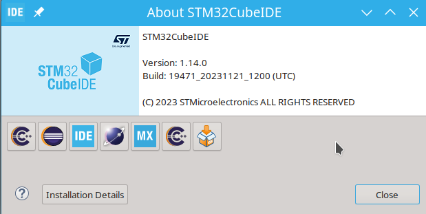

I'm using the last version of CubeIDE AFAIK :
