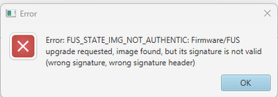

I am trying to perform a firmware upgrade but I keep receiving an error message Error: Rollback to older version of FW detected and not allowed!
Is there a way to get around this error? I have added a photo of the stm programmer page.
Additionally - can someone please confirm the order of performing an update? Should it be as follows?
Upgrade with stm32wb5x_FUS_fw_for_fus_0_5_3.bin
Upgrade with stm32wb5x_FUS_fw.bin
Upgrade with (in my case): stm32wb5x_BLE_Stack_full_fw.bin
Can I just jump to upgrading with stm32wb5x_BLE_Stack_full_fw.bin without the previous two? Thanks a lot as this is really quite the challenge for me currently.
In this case the stack reference version is considered as 0xFFFFFFFF (while no stack installed and anti-rollback is activated), so no firmware update is allowed after that, and no recovery is possible at this point.

Hello @od805
I think you have activated the Anti-rollback without ensuring that a wireless stack is correctly installed. If so, the FUS registers 0xFFFFFFFF as the new version, and it is not possible to install a wireless stack. For more details about Anti-rollback activation, I suggest you take a look at the part 2.4 of the AN5185.

So if this is the case is this board no longer usable?

Trying to work on a new board and running into this error when installing stm32wb5x_FUS_fw_for_fus_0_5_3.bin
I know the documents may outline how to navigate this but I would greatly appreciate how to fix this error from experts instead of reading the documents(s).
Please advise.
If the original FW version, is not the 0.5.3, then you have to use directly the stm32wb5x_FUS_fw.bin. Try a full chip erase. Then, try firmware upgrade using the stm32wb5x_FUS_fw.bin and following this Wiki.
