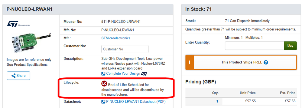

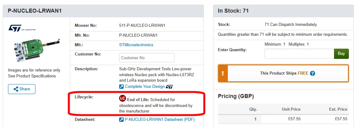

P-NUCLEO-LRWAN1, available from Mouser for $71.62
Or
SX1272MB2DAS $31.68
NUCLEO-L073RZ $13.81
$45.49
Andrew Neil
December 6, 2024
Indeed:
