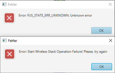

  14:17:28:541 : Warning: FUS_STATE_ERR_UNKNOWN
  14:17:28:541 : r ap 0 @0x20002F04 0x00000004 bytes Data 0x00000000
FUS info also looks weird?!
I also can't start the wireless stack:

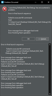

I also can't flash user code, I get this:
Error: Data mismatch found at address 0x08000000 (byte = 0xFF instead of 0x7F)
Error: Download verification failed
Warning: The core is locked up
When trying to flash user code with STM32CubeIDE I get this:
