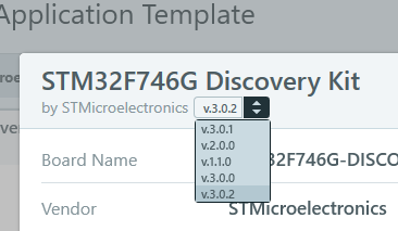

  1. The AT. version dropdown is not showing in ascending order. The newest is selected but the order is.. odd.0693W000006GNOgQAO.png

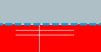

  2. The border around the canvas is covering the first pixel on the screen.I was finetuning my display timings and I noticed that placing a line on Y=0 with a width of 1 the line would not show. If I move the line to Y=1 I can see the line just below the border. In the picture I am using the show/hide clipped content to allow me to view the line that would otherwise be hidden0693W000006GNPAQA4.png
