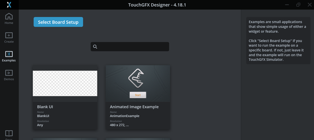

Unfortunately I can't help with the problem you're facing, I can only help with TouchGFX Designer examples; Cube demos aren't something we can manage with Designer. I can suggest you to use examples that we provide on TouchGFX Designer directly. For that, you can click on "Example" panel on the left, and "Select board setup".
0693W00000JPRV2QAP.pngYou will be able to select  STM32H745I-DISCO board from there, and you'll be given all specific examples for the board you're working with. All these examples are already configured with STM32CubeMX and runnable on target.

I have already tested a few different Examples (Blank UI, Clock Example and Button Example) to try it on my target board. In "Select board setup" i have chosen the board STM32H745I DISCO, that should be the same as my target board.
If i click on "generate code" or "simulator" it runs perfectly. But if i click on "run target" it runs to the end but the screen on my target is still white.
