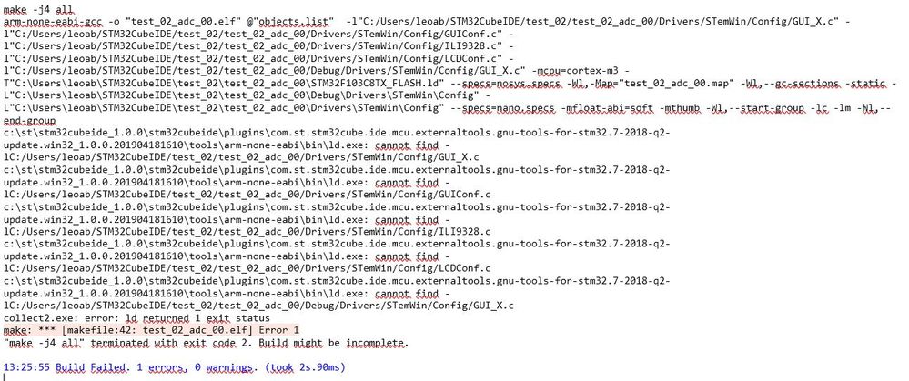

When i Build the proyect the next error occur. make: *** [makefile:42: test_02_adc_00.elf] Error 1 The complete error is on capture I had attached by character limit.
  • May 16, 2019
  • 3 replies
  • 1202 views
I am working on STM32CubeIDE and i try to compiling STemWin for first time.
collect2.exe: error: ld returned 1 exit status
The complete error is on capture (phat_and_symbols_04.jpeg) or below
13:25:53 **** Incremental Build of configuration Debug for project test_02_adc_00 ****
make -j4 all
arm-none-eabi-gcc -o "test_02_adc_00.elf" @"objects.list" -l"C:/Users/leoab/STM32CubeIDE/test_02/test_02_adc_00/Drivers/STemWin/Config/GUI_X.c" -l"C:/Users/leoab/STM32CubeIDE/test_02/test_02_adc_00/Drivers/STemWin/Config/GUIConf.c" -l"C:/Users/leoab/STM32CubeIDE/test_02/test_02_adc_00/Drivers/STemWin/Config/ILI9328.c" -l"C:/Users/leoab/STM32CubeIDE/test_02/test_02_adc_00/Drivers/STemWin/Config/LCDConf.c" -l"C:/Users/leoab/STM32CubeIDE/test_02/test_02_adc_00/Debug/Drivers/STemWin/Config/GUI_X.c" -mcpu=cortex-m3 -T"C:\Users\leoab\STM32CubeIDE\test_02\test_02_adc_00\STM32F103C8TX_FLASH.ld" --specs=nosys.specs -Wl,-Map="test_02_adc_00.map" -Wl,--gc-sections -static -L"C:\Users\leoab\STM32CubeIDE\test_02\test_02_adc_00\Debug\Drivers\STemWin\Config" -L"C:\Users\leoab\STM32CubeIDE\test_02\test_02_adc_00\Drivers\STemWin\Config" --specs=nano.specs -mfloat-abi=soft -mthumb -Wl,--start-group -lc -lm -Wl,--end-group
c:\st\stm32cubeide_1.0.0\stm32cubeide\plugins\com.st.stm32cube.ide.mcu.externaltools.gnu-tools-for-stm32.7-2018-q2-update.win32_1.0.0.201904181610\tools\arm-none-eabi\bin\ld.exe: cannot find -lC:/Users/leoab/STM32CubeIDE/test_02/test_02_adc_00/Drivers/STemWin/Config/GUI_X.c
c:\st\stm32cubeide_1.0.0\stm32cubeide\plugins\com.st.stm32cube.ide.mcu.externaltools.gnu-tools-for-stm32.7-2018-q2-update.win32_1.0.0.201904181610\tools\arm-none-eabi\bin\ld.exe: cannot find -lC:/Users/leoab/STM32CubeIDE/test_02/test_02_adc_00/Drivers/STemWin/Config/GUIConf.c
c:\st\stm32cubeide_1.0.0\stm32cubeide\plugins\com.st.stm32cube.ide.mcu.externaltools.gnu-tools-for-stm32.7-2018-q2-update.win32_1.0.0.201904181610\tools\arm-none-eabi\bin\ld.exe: cannot find -lC:/Users/leoab/STM32CubeIDE/test_02/test_02_adc_00/Drivers/STemWin/Config/ILI9328.c
c:\st\stm32cubeide_1.0.0\stm32cubeide\plugins\com.st.stm32cube.ide.mcu.externaltools.gnu-tools-for-stm32.7-2018-q2-update.win32_1.0.0.201904181610\tools\arm-none-eabi\bin\ld.exe: cannot find -lC:/Users/leoab/STM32CubeIDE/test_02/test_02_adc_00/Drivers/STemWin/Config/LCDConf.c
c:\st\stm32cubeide_1.0.0\stm32cubeide\plugins\com.st.stm32cube.ide.mcu.externaltools.gnu-tools-for-stm32.7-2018-q2-update.win32_1.0.0.201904181610\tools\arm-none-eabi\bin\ld.exe: cannot find -lC:/Users/leoab/STM32CubeIDE/test_02/test_02_adc_00/Debug/Drivers/STemWin/Config/GUI_X.c
"make -j4 all" terminated with exit code 2. Build might be incomplete.
13:25:55 Build Failed. 1 errors, 0 warnings. (took 2s.90ms)

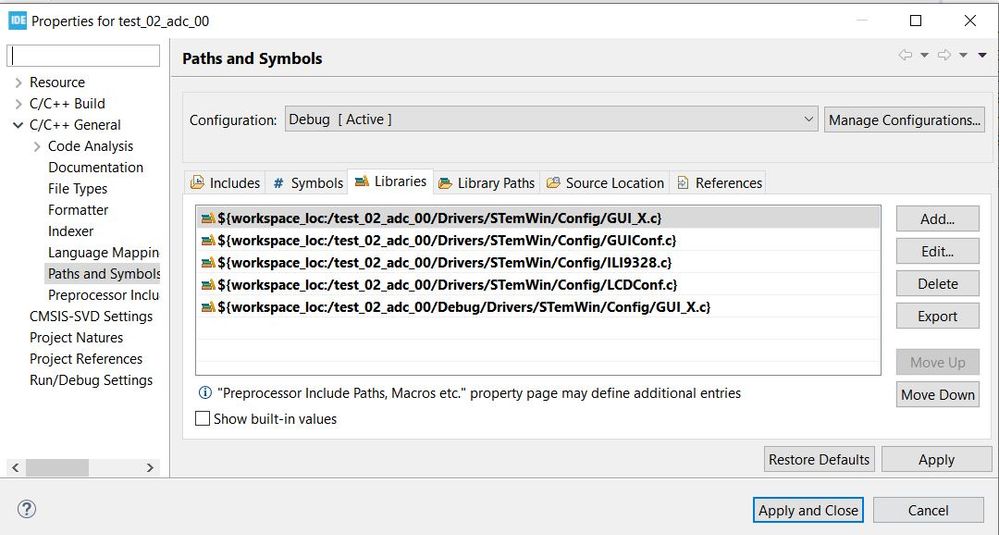

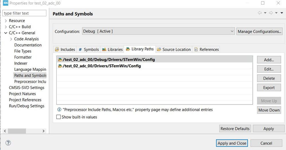

In the Propieties-> Path and Symbols I was try to configure but not work.
The what i do wrong?

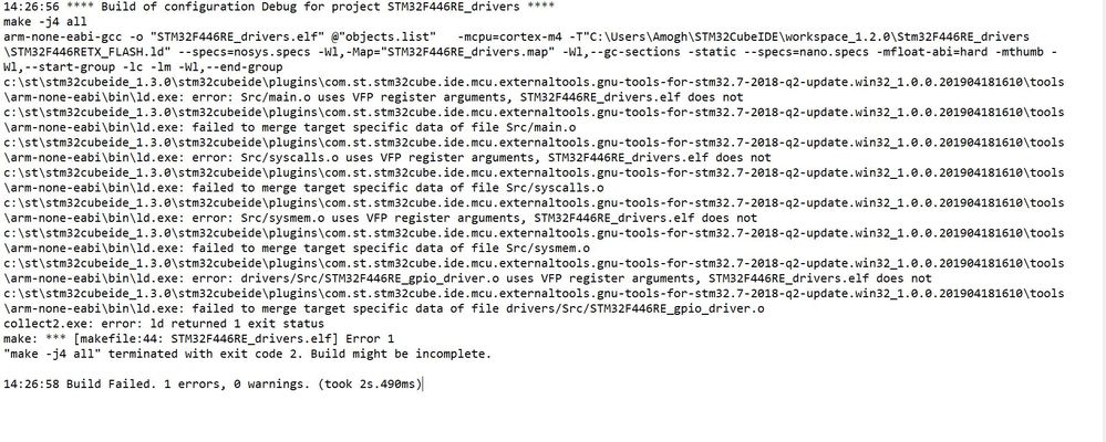

I am getting similar kind of error.
Any help with it would be appreaciated
Thank you,

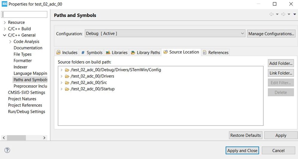

Those files are not libraries, they are source files. You'll need to mark the directory as a source directory, or similar, so they are compiled along with everything else. Alternatively, move them into your source directory.

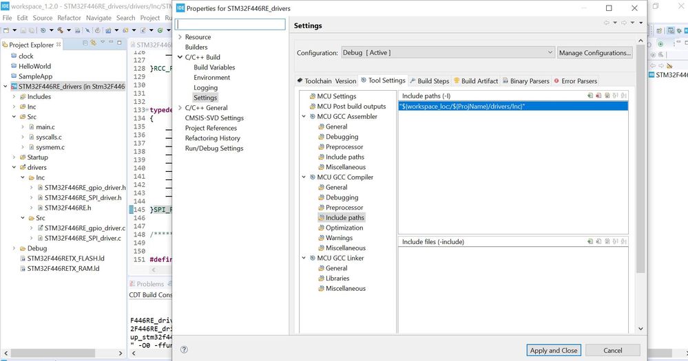

Attached screenshot of my error logs.
The path has already been added. Attached the screenshot below
Thank you for the help!!
