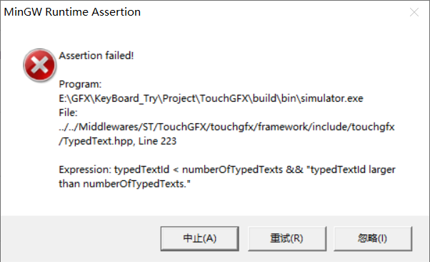

Hi
I want to creat my keyboard , but the problem arises.
I have to make it as close to the touchgfx example as possible, but the problem remained.
I'd appreciate your advice.
Thank you.

Looks like you're trying to reference an ID that doesn't exist. Can you try re-generating code?
/Martin
/Martin

Thank you very much for your advice.The problem was solved
