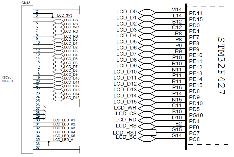

I'm trying to use TFT display with ILI9341 16 bit interface with STM32F427 via FMC.  I based my code looking the samples gerates for CubeMX.
I am using FreeRTOS and STemWin to print the 'Hello Word' message, but it does not work, in this case I have not found many examples of how to use the FMC.
I created the file stm32f427xx_eval.c with the routines that StemWim will use to write to the lcd.

Vangelis Fortounas
September 25, 2017
Posted on September 25, 2017 at 14:22
Hello Jorge!
Code seems functional.
But is not enough to sucessfully display the 'Hello world'
What about LCD_conf andGUI_conf  files?
I suggest to remove the
FreeRTOS until you have fully functional the LCD (after, you can use it with minor changes to your code).
When first time connected a 16 bit LCD to FMC it tooks me at least 10 days to make it work (needs good study of LCD's UM)
Do you have some schematic to post? (connections between LCD and FMC also the IM[3:0]  pins)  It will helps the community to advise you.
Regards
vf
jorge guzman
September 25, 2017
Posted on September 25, 2017 at 15:13
Hello Vangelis,
Thanks for answering, this is the connection i'm using.
I shared all the project in
https://community.st.com/servlet/JiveServlet/download/43760-1-9628/Project1.zip
for more details.

Vangelis Fortounas
September 25, 2017
Posted on September 25, 2017 at 17:47
Hello again!
The BSP function void ili9341_Init(void)
initializes the ILI9341 to RGB mode that is compatible with STM32f429 discovery board.
Make some search to find a more appropriate initialization sequence.
I use same controller in SPI mode, When i tried to 'decode' the  initialization code from same BSP, i found that a lot of  commands there was n't in ILITEK datasheet!
But, try  first to read from LCD the ID code to be sure that your other code is functional.
regards
