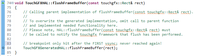

Considering existing posts and instructions in the documentation, I can't manage the framework to call flushFrameBuffer() regularly after a vsync.
The main issue is that TouchGFXHAL::flushFrameBuffer() is only called once after the first OSWrappers::signalVSync() (and never again). I've deleted all display drivers and checked with a breakpoint that is only hit once in TouchGFXHAL::flushFrameBuffer(). OSWrappers::signalVSync() is triggered by a button and an external interrupt callback. All code that I added is attached. The board is a F303RE Nucleo. Settings of TouchGFX see below.

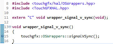

Sync wrapper. Breakpoint hit on each button press.
Callback on button press. Calls the wrapper function from above.0693W000008GH03QAG.png

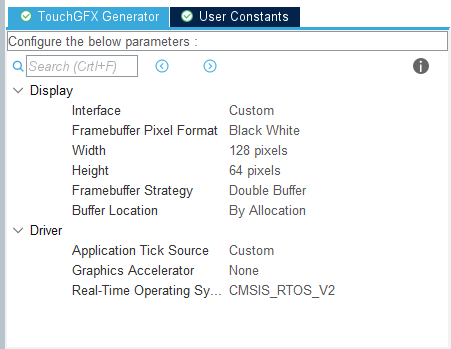

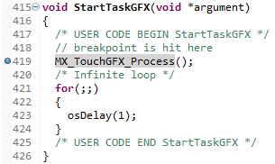

Breakpoint gets hit.0693W000008GH6PQAW.pngBreakpoint only hit on first button press!0693W000008GH6jQAG.pngTouchGFX settings.0693W000008GH6oQAG.png

I'm aware of that. But all of the transmission (e.g. start of SPI DMA) would be located in TouchGFXHAL::flushFrameBuffer(), which is not executed (more precisely: it is only executed once after the very first vsync). That's why I have deleted all display driver code for this forum.
check if gpio exti for you work once or more

The LED toggling works as expected. Also, a breakpoint in OSWrappers::signalVSync() is hit on each button press.

Indeed, the flushFrameBuffer function is called by the TouchGFX library only when something has changed in the frame buffer.
