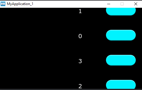

You can use callbacks to trigger parent (view) when some of those three widgets is pressed. Here is simple example, modified from some old example. I was lazy and use flex button as text box. You run it on simulator, it is made in version 4.21.4 but seems to work also on later versions.
Hopefully you get the idea out of it.
Br JTP

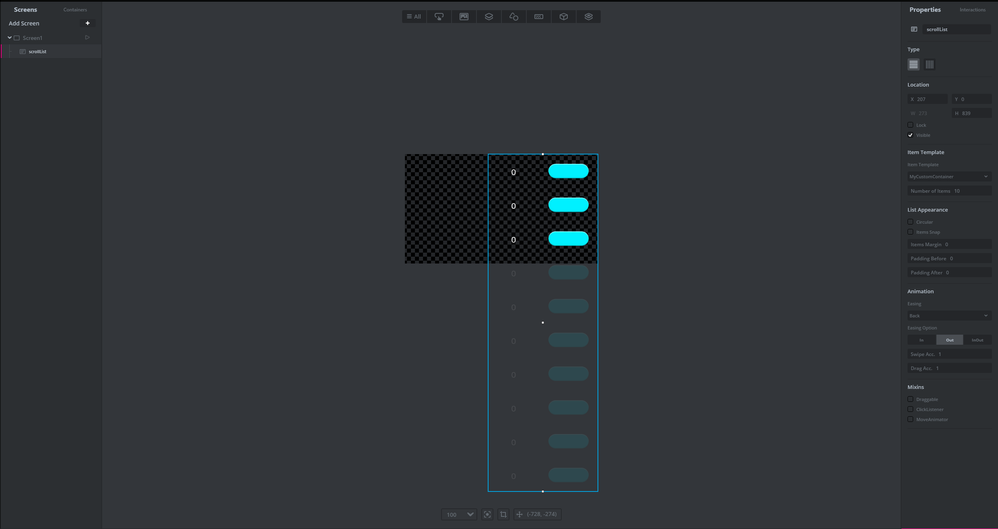

Based on the picture you have provided, I suggest you to create a Custom Container first, and handle the logic there (in other words, implement the function for updating the state inside to custom container class). Then, you can use a Scroll List with the custom container you created as its Item Template. You have to set the number of items and make sure the list is large enough to show all the available items (probably the list will go outside of the screen which is fine).
I have uploaded a photo to demonstrate how your scroll list should look like.
Picture of the designer
Running of the program
Honestly, I didn't understand your point about item being decided on runtime. Do you mean you want to change the items of the list while the application is running?
