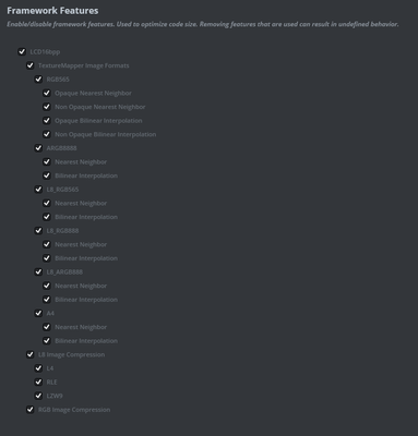

June 12, 2024
Have you checked all the framework features checkboxes in TouchGFX (under Config)? Try checking all of those and regenerating code in TouchGFX.
"Kudo posts if you have the same problem and kudo replies if the solution works.Click ""Accept as Solution"" if a reply solved your problem. If no solution was posted please answer with your own."
June 12, 2024
I've checked all of them and the error just continues, i did not touch any framework before so.
