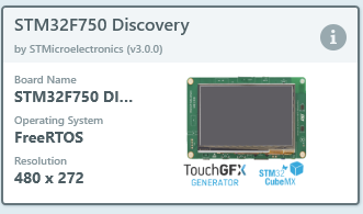

Which board and application template version are you using? The default configuration is not always CMSIS v1, as we have updated most of the ATs to CMSIS v2.
/Romain
Hi Romain,
Thank You for your response !
This is the application template I chose :
Alex

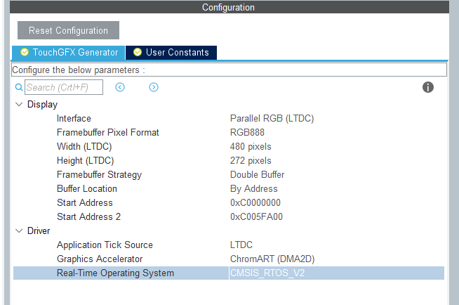

Hello Alexandre,
I have deleted and regenerated like you recomended, but my problem persists... I can compile and flash but I get a black screen on my devboard (Before the change it worked).
As per the touchGFX config menu, I am not sure what menu you are talking about, is this the one ?
Thank You ,
Alex

No the compilation problem has been resolved and now you have another problem :)
At least you are one step further now.
Yes I was talking about this config menu.
We noticed sometimes that CMSIS v2 does not work on some board but v1 works and vice versa. This is also probably why we haven't changed to v2 for this board.
Also, æake sure that the FreeRTOS v2 is well configured: For instance, your touchgfx task need a certain size to work correctly. Please have a look at the CubeMX config of the L4R9-Disco Application Template that uses CMSIS v2 for reference.
/Alexandre
