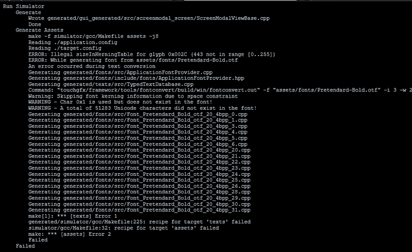

I set the wildcard range to 0x0000-0xFFFF to use all characters contained in the "Pretendard JP" font.
However, I get an error when generating code with TouchGFX Designer.
Of course, specifying small wildcard ranges work, but I also want to support multiple languages ​​with as few language packs as possible.
Is there another way to include all characters in one resource without specifying wildcards?
I also tried entering about 20k Unicodes into the Wildcard Characters field, but the error was the same.
== Error message ==
ERROR: Illegal sizeInKerningTable for glyph 0x002C (439 not in range [0..255])
ERROR: While generating font from assets/fonts/PretendardJP-Bold.otf
An error occurred during text conversion
Cleaning generated files from generated/texts and generated/fonts.

Command: "../Middlewares/ST/touchgfx/framework/tools/fontconvert/build/win/fontconvert.out" -f "assets/fonts/PretendardJP-Bold.otf" -i 13 -w 16 -r 16 -o "generated/fonts" -c "generated/fonts/UnicodeListPretendardJP_Bold_otf_16_4.txt" -n "PretendardJP_Bold_otf" -b 4 -v 0 -d 63 -e 0 -ct yes -bf no -ff 0 -ffu 0 -ba
Warning: Skipping font kerning information due to space constraint
WARNING - Char 0x1 is used but does not exist in the font!
WARNING - A total of 43561 Unicode characters did not exist in the font!

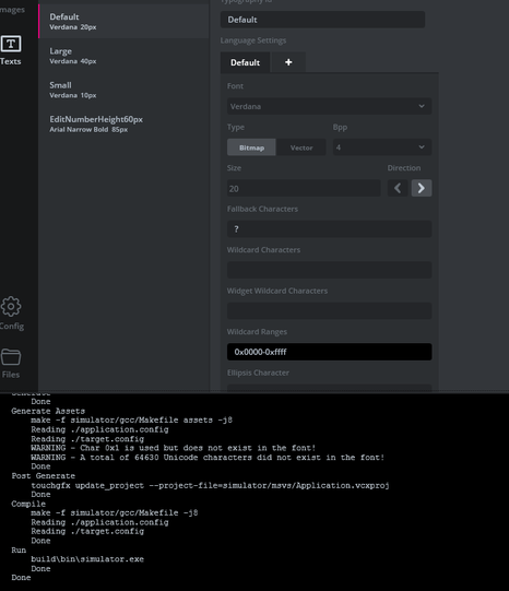

    Hi @potentializ
    My project runs Okay. Only get warning:
    WARNING - A total of 64630 Unicode characters did not exist in the font!
    Generating generated/fonts/src/Table_verdana_20_4bpp.cpp
    It seems there is some error with a specific font internaly in you project, maybe structure broken ?

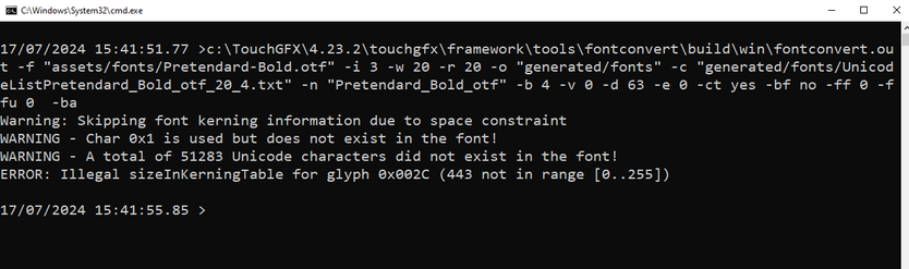

    Maybe you could try to run Gfx font converter tool on its own from Windows CLI to learn more about the issue with specific font file. Or create a dummy project with single font causing a problem.

    I downloaded the font
    https://fontmeme.com/fonts/pretendard-font/
    and got an error as well:
    And fontconvert.out ran in CLI
    The tool is here
    c:\TouchGFX\4.23.2\touchgfx\framework\tools\fontconvert\build\win\fontconvert.out
    @GaetanGodartThis error might be something fontconverter Dev team might want to look at. The font does not seem to be 'corrupt' as I was able to open it in FontForge application.
