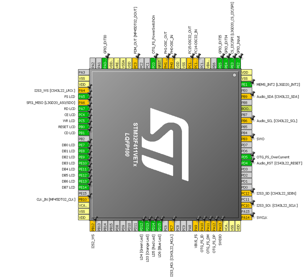

What's your hardware connection?
Posted on April 13, 2018 at 13:42
This is the discovery board stm32F411 .
Posted on April 14, 2018 at 08:39
OK but how did you connect the display to that board?
Posted on April 16, 2018 at 08:39
Hi , Sorry , i forgot the pin-map !
As you can see , on the left , there is all LCD connection.
Posted on April 17, 2018 at 10:22
So you have them in a proper order on a single port. That makes things easier.
As the bus is bi-directional, you have to change the direction of the pins between GPIO Input and GPIO Output, according to whether you are going input or output data. This is done by setting the respective bits in GPIOE_MODER - for each pin, Input is when the respective two bits are set to 0b00, and Output is when they are set to 0b01; so
GPIOE->MODER &= ~(0b0101010101010101 << 7);
GPIOE->MODER |= (0b0101010101010101 << 7);
The data output is best to be done through the BSRR register. You take your input byte, and then set (by writing 1 to the lower 16-bits of BSRR) those bits in it which are 1; and clear (by writing 1 to the upper 16-bits of BSRR) those bits which are 0; so it's something like:
GPIOE->BSRR = (byte << 7) + (((~byte & 0xFF) << 7) << 16);
I don't know the Cube incantations for these, I don't Cube.
Posted on April 19, 2018 at 15:01
Thank JW for your help, i understand a little bit
I try to use your method into my code but i have one problem when i want to recover the values of my data.
The method that i use doesn't works ..
I attach my code :
My problem is in LCD.c
When i use thisGPIOE =command;
Thank for your help
Anaelle
