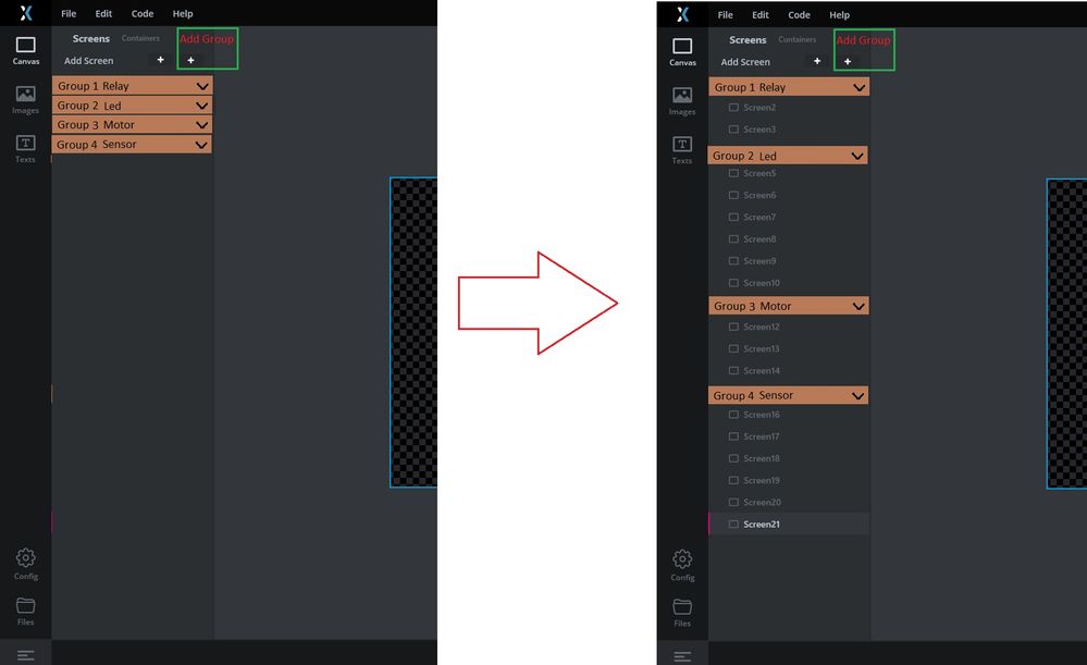

hi
When there are many menus, finding them becomes a bit difficult. If this menu is added, it will be possible to categorize them.16297084997291791.jpg

Hello @Natali ,
Thank you for this very interesting idea! We've already considered adding a feature to create groups of screens. While I can confirm that this feature is on our roadmap, I cannot provide a specific release version or date at this time.
For the second request, we need to find the best way to categorize the files in general. You suggested separating 'ScreenViews' and 'ScreenPresenters', for instance, but we've heard from other users who want to separate screens instead, like 'Screen1' and 'Screen2'. We are trying to figure out what makes more sense.

I saw your post regarding the difficulty of sorting screens in TouchGFX Designer. I’d like to suggest a possible workaround that might help.
If you establish a consistent naming convention for your screens and containers (e.g., prefixing them with numbers or categories), you can use a PowerShell script I created called sort.touchgfx.
This script sorts the screens and containers inside the .touchgfx file in alphabetical order, making it easier to manage large projects. It works by treating the .touchgfx file as JSON and reordering the entries automatically.
Would this approach be helpful in your case?

Hi
In the project I'm currently working on, I have 80 pages and 45 containers so far. This means there are over 200 different files in the GUI folder. The only thing I've done so far is naming all the containers with the CNTR_ prefix, which at least ensures they are grouped together in one place. For the rest of the menus, I'm also trying to choose a consistent prefix so they are arranged sequentially as well.
