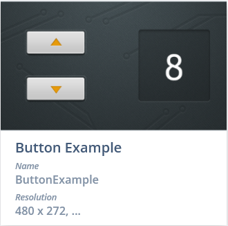

Using a STM32F746G-Discovery board and TouchGFX 4.20.0, the on-screen buttons of the "Button example" as distributed with the TouchGFX package do not respond after the board is reset via the reset button or on a power-up reset. When flashing the code and the ST-Link debugger resets the processor, it works fine, as well as when the processor is reset with STM32CubeProgrammer. Also works as expected under debugger control.
The processor is running fine, as established through a simple LED flashing routine in the HAL_TIM_PeriodElapsedCallback ISR.
Has this "feature" been seen elsewhere? Any ideas to the cause of this?

The problem manifested itself in my own application and as a fallback I tried the Button Example as supplied with TouchGFX 4.2.0: 0693W00000VOsYTQA1.pngThis example is simple enough to only address the issues I am experiencing.
The board setup is only supported from TouchGFX4.20.0 as described by the board description, so no, I have not tried older versions.
When the compiled application is deployed with Debug (-Og) optimization, it operates as expected after a debugger reset. Any other reset, reset button or power cycle makes the button inoperable. When the application is deployed with Size (-Os) optimization and no debug support, it fails from the onset, no touch screen activity.
