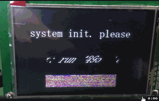

stm32f401rct uses partial framebuffer to display skewed when refreshing the control,
  • April 27, 2022
  • 6 replies
  • 3523 views
0693W00000Lz91nQAB.gifUsing threadx rtos, spi is written to st7796 rbg565 480*320, the interface display is normal during initialization, but it is abnormal when the widget is refreshed in handletickevent

victor.wu
victor.wuAuthor
April 27, 2022
Does anyone know the reason, thank you very much for your help

Maybe better is show your code for init display and refresh system.

A workaround method is adopted here. A global variable is judged in the timer interrupt. If the writing spi tft thread has completed the transmission, it will be executed.

victor.wu
victor.wuAuthor
April 27, 2022
From the phenomenon, it seems that the touchgfx kernel has data misalignment when rendering part of the buffer, and it has been repeatedly confirmed that the spi program written to the st7796 is correct.

victor.wu
victor.wuAuthor
April 28, 2022
