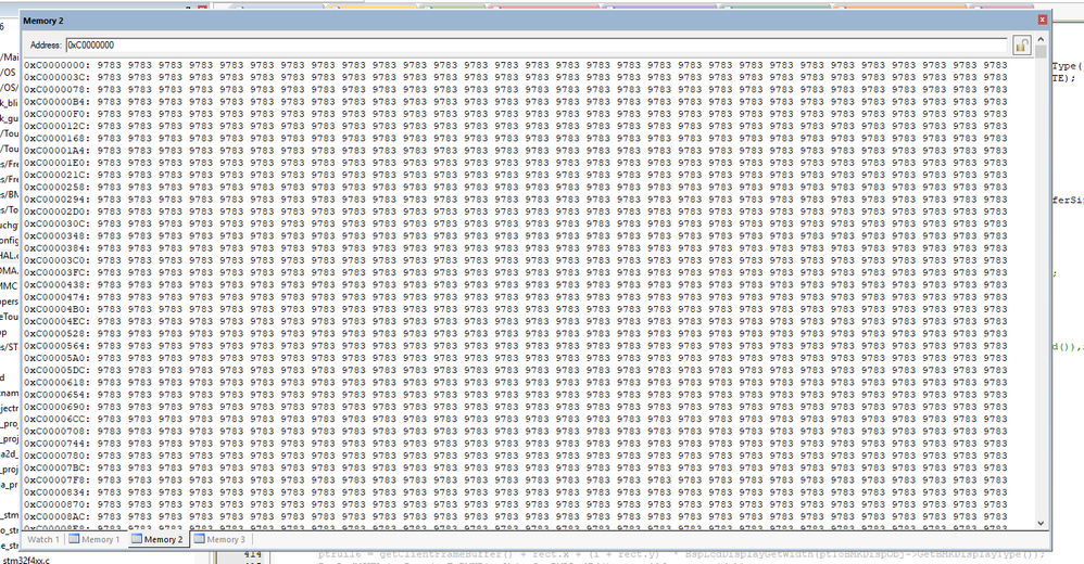

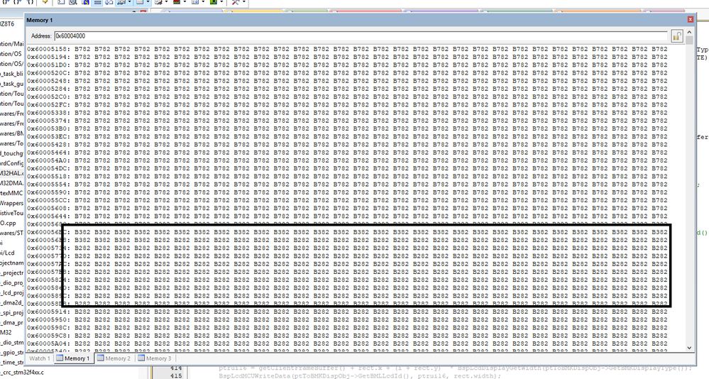

‎2020-08-07 5:19 AM
You mean, the readout of the SDRAM in debugger changes spontaneously?
I have only anecdotal experience with SDRAMs through STM32 FMC (basically just playing with a 'F429 Disco) - the errata didn't plant much confidence do we tried to avoid it in our designs so far ...
‎2020-08-07 5:31 AM
Yes I mean that but not in SDRAM, rather in memory area in FMC. For example one color over the entire area is in frame buffer (located on SDRAM) ok. But after copying the data to FMC memory area there are some "corrupt data" which means the display area contains other data instead of the color.
See screenshoots
greetz
‎2020-08-07 2:26 PM
OK so it's the LCD controller side which is problematic, and if colour is incorrect, it will be at least the write (still may be read, too, and SDRAM read, too).
Hard to tell exactly what may be the reason with having the system physically at my bench... I have a working design with SSD1963 but was quite a challenge to get the it right, IIRC it did not exactly follow the timing in its datasheet and timing had to be relaxed. I don't remember the details (worked with several LCD controllers and the individual details tend to blur...)
OTOH, the screenshot indicates flipped bits, which might be also due to inadequate ground/return and/or crosstalk, so maybe some careful oscilloscope work might be useful, too.
