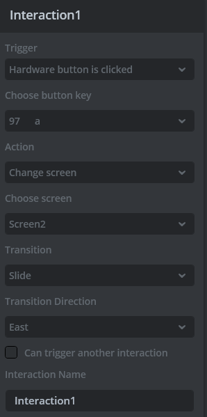

Hello Anthony,
There's another way to read any character from your keyboard, just by using Interactions in TouchGFX Designer. Indeed, a new interaction with "hardware button is clicked" as the trigger will allows you to use your keyboard.
For instance, this configuration :
0693W00000QNswxQAD.pngmeans that if you click on the letter "a" on you keyboard, you will change the screen to screen2.
I'm attaching a project you can use if you need. It's 2 screens that can be switched by pressing on the keyboard.
/Osman

AMars.4
AMars.4Author
August 17, 2022
Hi Osman,
Appreciated, I was looking for a way to do this in code so didn't think to check in the designer.
So this way I can keep my application simpler, checking on RTOS message queues in the model tick for the hardware, and waiting on a keypress for the simulator (to call a virtual function most likely).
I will look at the example you sent, thanks again.
Anthony
