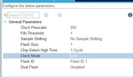

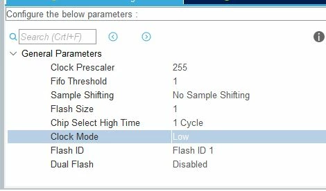

Hello, region `FLASH' overflowed by 424008 bytes but i didn't added much image. I am using 128 Mb N25Q128A13EF840E QSPI flash. I just wanted to confirm how much QSPI is assigned.
I can see below settings for QSPI.
I want to know that Where should I check in my firmware to know assigned external flash size. I can't find in linker file?
Also I want to see which all data is saved in QSPI 128Mbit .
Any help

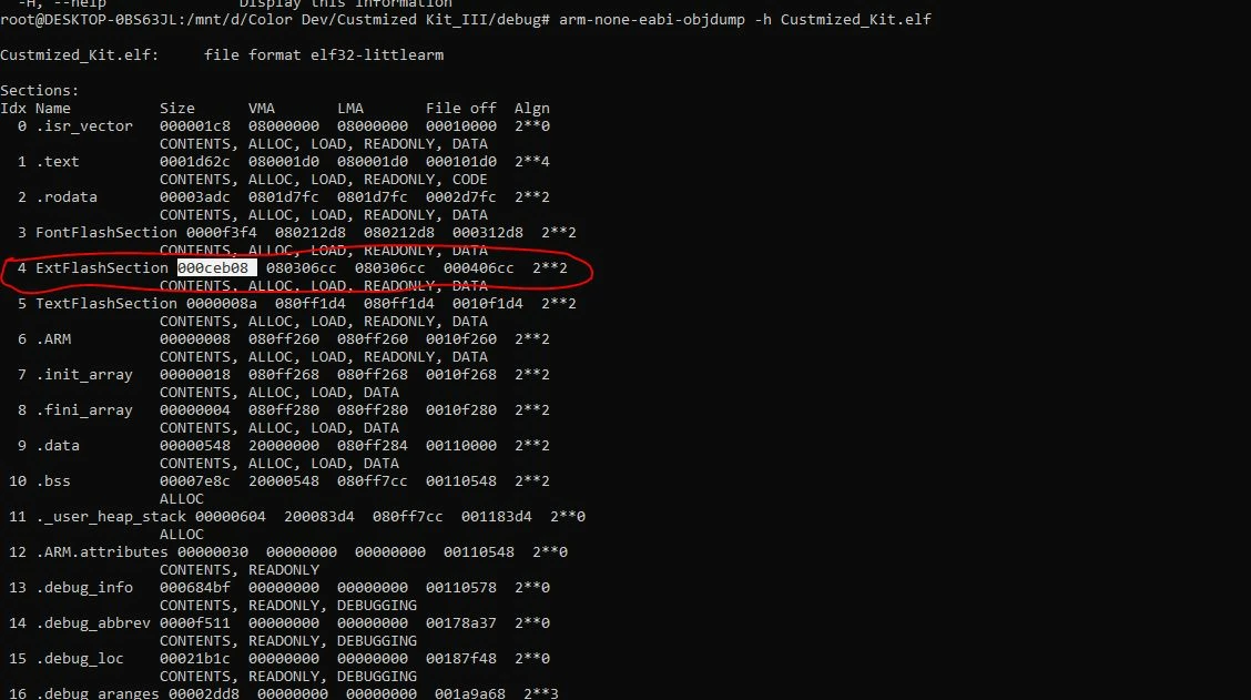

I dig a bit more and check using gcc objdump command. Here u can see external flash size is 0xCEB08 which I think In bytes. So this does not cross 128Mbit.
Note : In this case I removed most of images and as per compiler its almost filled.

Wait, how do you configure your QSPI?
Are you using the settings you posted in the first picture?
There are two things you need to do:
  1. set the linker script so the ExtFlashSection is actually located in the QSPI region
  2. setup the QSPI so it matches your memory.
In the first picture you have a flash size of '1' - this means that you are using 1 bit for address space effectively limiting your memorysize to 2 bytes..
