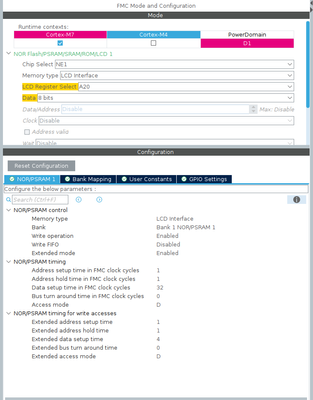

I'm using the FMC to access the display.
Maybe my description was a bit off. The read ID of 0x242424 is manipulated to 0x484848.
The expected value for the read ID would be 0x858552. The expected ID is never manipulated.
I really can't find anything how to setup this besides copying settings from the H723 example.
