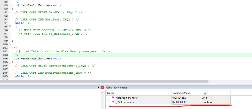

Program crashed when I declare a array of Custom Container and add it to scrollableContainer in a constructor.
I want to display a list of Custom Container in a scrollableContainer .
So I write the code like blow.
//declare in public
std::vector <menuDisplayContent> menuDisplayContanier;
//in constructor
menuDisplayContanier.resize(5);
for (int i = 0; i < menuDisplayContanier.size(); i++)
 menuDisplayContanier[i].setY( i * 170);
	scrollableContainer1.add(menuDisplayContanier[i]);
It worked in PC simulator.But crashed when enter this screen in real board.
Firstly,I doubt the leak of heap is the reason. So I expand the heap size from 0x2000 to 0xF000. It crashed again. The heap size like below.
//in startup_stm32f429xx.s file
Stack_Size		EQU 0x4000
 AREA STACK, NOINIT, READWRITE, ALIGN=3
Stack_Mem SPACE Stack_Size
__initial_sp
; <h> Heap Configuration
; <o> Heap Size (in Bytes) <0x0-0xFFFFFFFF:8>
; </h>
Heap_Size EQU 0xF000 // I change the heap size here.
 AREA HEAP, NOINIT, READWRITE, ALIGN=3
__heap_base
Heap_Mem SPACE Heap_Size
__heap_limit
 PRESERVE8
 THUMB
Now, I can not find the reason. Is there other reason lead to this phenomenon?

I put this piece of code in a "menuDislpayScreenView::menuDislpayScreenView():" constructor.
All the code like below:
// in menuDislpayScreenView.hpp
class menuDislpayScreenView : public menuDislpayScreenViewBase
public:
 menuDislpayScreenView();
 virtual ~menuDislpayScreenView() {}
 virtual void setupScreen();
 virtual void tearDownScreen();
protected:
// in menuDislpayScreenView.cpp
	menuDisplayContanier.resize(6);
void menuDislpayScreenView::setupScreen()
 menuDislpayScreenViewBase::setupScreen();
		menuDisplayContanier[i].initialize();
It worked in PC simulator, but crashed in real board.

Have a functional Hard Fault Handler so you can catch failures there.
The constructors may be called before external memory and peripherals are functional.​

How can I find the cause of hard fault.
