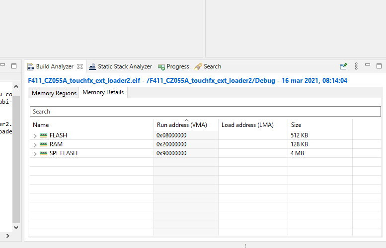

I create a screen with TouchGFX, press "Generate Code", compile with STM32CubeIDE and everything goes well. The problem is that if I launch the debug from STM32CubeIDE it seems that I cannot find the .BIN file to load in the external flash memory ...

To flash your board, if you are using external memories (external RAM for Framebuffer and/or external Flash for assets), you need an external loader.
Also, CubeIDE does not use the .bin file, it uses the .elf binary file to download the code into your board.
/Alexandre

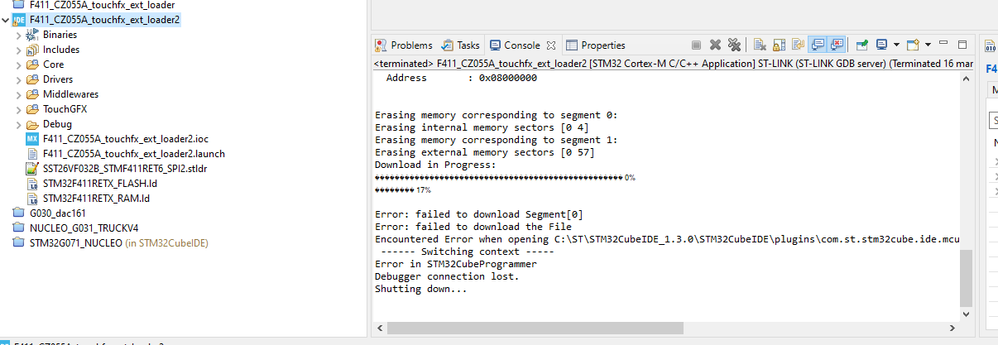

I have created an external loader called "SST26VF032B_STMF411RET6_SPI2.stldr" and it works correctly with "STM32CubeProgrammer".
If I launch the debugger it gives me an error as you can see from the attached photo.
Am I wrong to place my external charger in the project?
‎2021-03-16 6:24 PM
Hello cb.7,
You are not wrong to use your external loader in CubeIDE which you used in CubeProgrammer. That is the correct procedure.
As why you cannot download into the board is not related to TouchGFX and I'm not an expert in CubeProgrammer/CubeIDE. Maybe try to add these tags to your request.
One thing you could try is download using CubeProgrammer and then debug without downloading with CubeIDE. I believe this option is available.
Also, after the download is successful with CubeProgrammer, is your project working ? Do you see the images stored in SPI flash displayed on your screen ? If not, are you sure your external loader is correct ?
/Alexandre

I saw that in the LOG it gives me this error:
