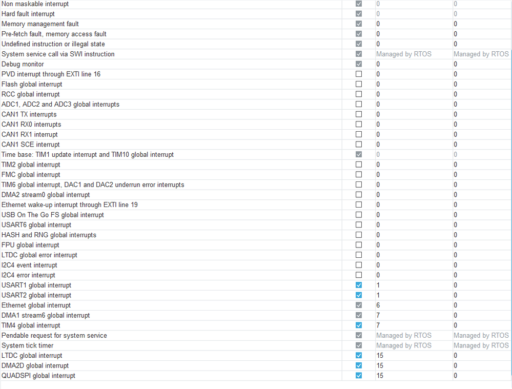

Hey @MM..1​ ​ , sorry i forgot to mention that I'm using FreeRtos. I already tried correcting priority levels but I couldn't get it working any better.
Here is screenshot of priorities :
0693W0000059GKjQAM.pngFreeRTOS priorities:
  1. User Interface (TouchGfx) task - osPriorityNormal
  2. EthIf task - osPriorityRealtime
  3. TCP/IP task - osPriorityHigh
  4. HTTP server task - osPriorityNormal
  5. DHCP task - osPriorityBelowNormal
If I understand correctly with the display question you meant how many redraw operations are done in my user interface. For testing purposes I'm displaying only one static white background and static text Hello World. So there is basically only one operation of drawing.
