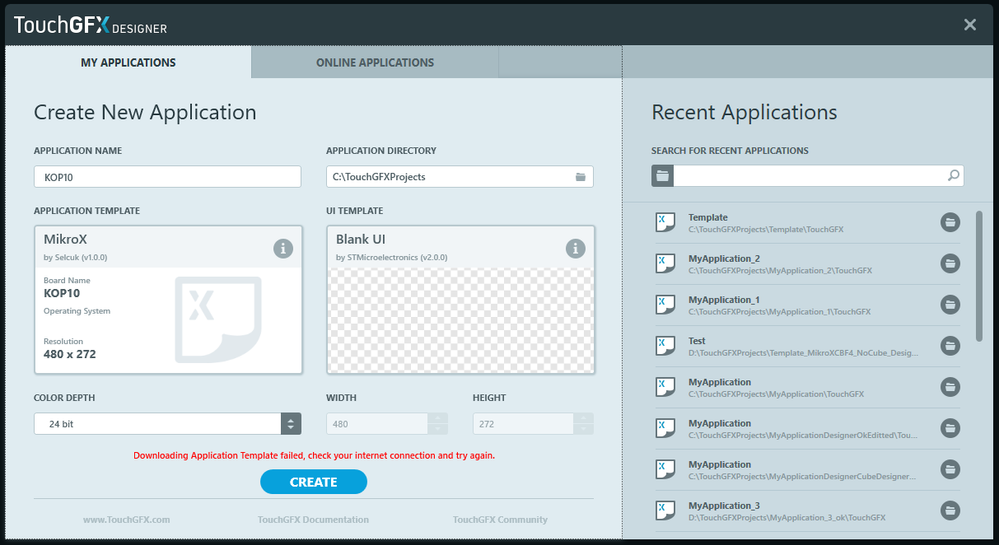

By following this guide (https://touchgfx.zendesk.com/hc/en-us/articles/115002741432-Create-custom-Application-Template) I have made an custom application template for our hardware. I'm able to select my application template in TouchGFX Designer (4.10.0) but when I press CREATE I get "Downloading Application Template failed, check your internet connection and try again". Does anyone have any suggestions?

Do you have a designer log file i can take a look at? I haven't encountered this issue before creating application templates.
/Martin
‎2019-03-15 1:55 AM
Now I have done the process again and figured out the problem. The name you set in the .touchgfx file ("name":"MyName") controls the name of generated files and the final .tpa file (MyName-1.0.0.tpa) and hence the name of this file cannot be changed.

5. Copied the .tpa generated into the related directory. Run the Designer and tried to start a project selecting my template. Here is the result:
Also here is the Designers' log file:
Strangely it is mentioned about STM32F769I-Disco not the one that I worked with which is STM32F429I-EVAL!
We have couple of our own custom boards which we use commercially and it will speed us up a lot if we use custom templates to produce new products.
So any help very much appreciated =)
