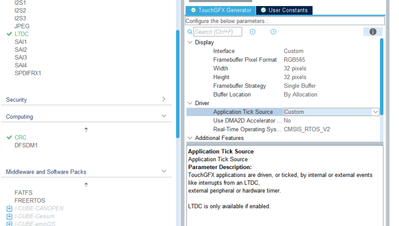

Hi all,
I am trying to configure the LTDC as TouchGfx application tick source but the CubeMX won't let me even if the LTDC is enabled.
Any ideas? Is there anything else that I should check?
I have already working code from other projects that I could manually integrate but then every time we regenerate the code it will be overwritten.
Thanks,
CMars.1
How silly of me. I forgot to select LTDC as display Interface.
I guess it's time to power-off the computer :)

Hello @CMars.1
Can you provide more information about your configurations, the board you are using,...
Best regards.
