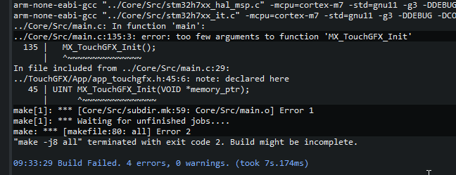

I have a build error where the call to MX_TouchGFX_Init(); in main.c (generated by Cube MX) is different than the one in app_touchgfx.h  UINT MX_TouchGFX_Init(VOID *memory_ptr);, also generated by CubeMX
I am using TouchGFX 4.19.1 in Stm32CubeIDE 1.9
Did anybody ran into that? Any suggestion?
build console output:
../Core/Src/main.c: In function 'main':
../Core/Src/main.c:135:3: error: too few arguments to function 'MX_TouchGFX_Init'
 135 |  MX_TouchGFX_Init();
In file included from ../Core/Src/main.c:29:
../TouchGFX/App/app_touchgfx.h:45:6: note: declared here
  45 | UINT MX_TouchGFX_Init(VOID *memory_ptr);
make[1]: *** [Core/Src/subdir.mk:59: Core/Src/main.o] Error 1

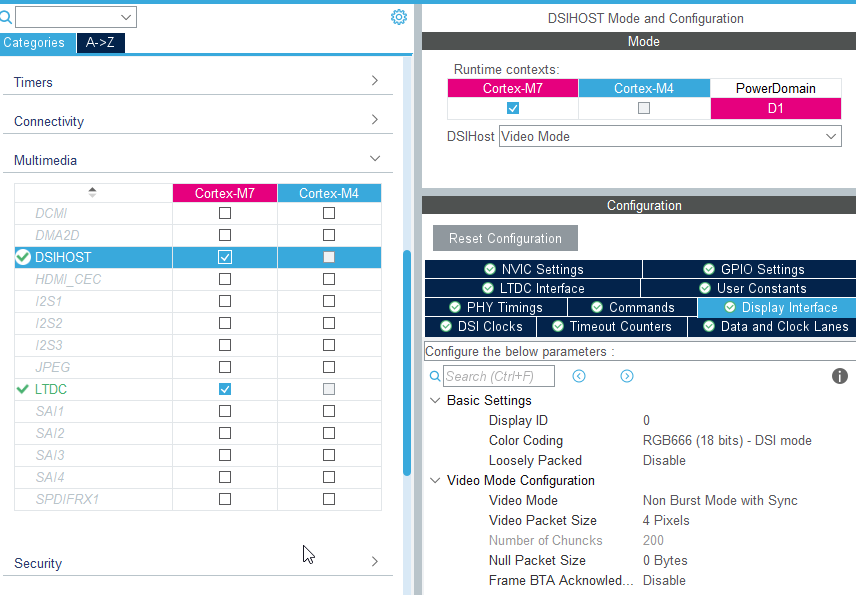

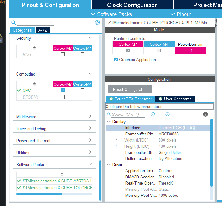

No, I have never got CubeMX and TouchGFX Designer to work, we did use TouchGFX Designer to generate some code last year (without STM32CubeIDE) but this was using a Disco (STM32H747) as a target. What I am trying to do now is to use the same STM32H747 as a target, but I tell Cube MX that this is a generic STM32H747 board (I wanted to get that to work before I start on our own hardware, to validate the tools).
SMalo.1
SMalo.1Author
April 19, 2022
Adding some information that I think might be relevant:0693W00000LyKl1QAF.png0693W00000LyKlaQAF.png0693W00000LyKmdQAF.png0693W00000LyKn2QAF.png

Hello @SMalo.1 ,
Maybe only one is re-generated when you click on "generate code". You could try to delete the generated files and re-generate.
If this doesn't work, I would advise to update your TouchGFX and STM32CubeMX software.
