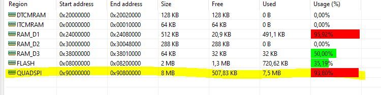

QSPI generally are very big, but sometimes not enough and they can become expensive.
I have a "big" project composed at the moment by 165 pictures and those required about 8MBytes of space.
0693W00000Dn2r2QAB.jpgIf tomorrow I will need to add some more pictures i will must to change the memory.
Instead , if touchgfx allow to manage also jpeg files the space involved by graphics contents can be reduce of 50% - 60% (maybe more).
In this case your final graphic will need only 3 or 4 Mbytes, instead of 8MB.
The internal decoder peripheral can decode easily and fastly the compressed picture and with DMA or passing from RAM can send to the Display.

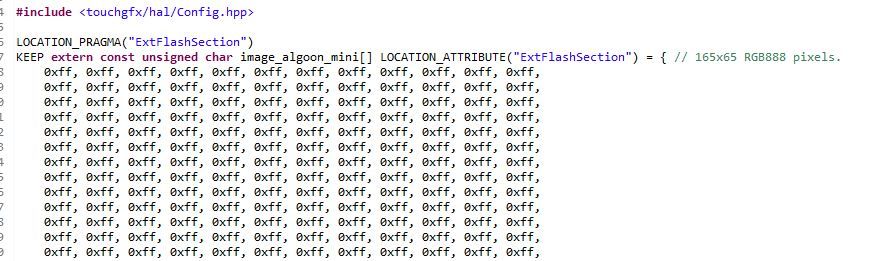

Every PNG image is decoded similar to:
0693W00000Dn2tDQAR.jpgand this is automatically saved in ExtFlashSection (QUADSPI) by the externalLoader when I program the microcontroller.
I think it could be very useful if Touchgfx designer allowed all other image formats to be imported into the project. In this way, all resources can be transferred to the QSPI with a single programming
MM..1
September 15, 2021
Maybe you dont understand code and timing for decoding formats "all other" will make for example change screen to other screen with 10 your compressed images maybe took more seconds , but now with prepared image format for LCD this took 20ms.
And as i write you can write external reader support for jpeg manualy stored in QSPI.
