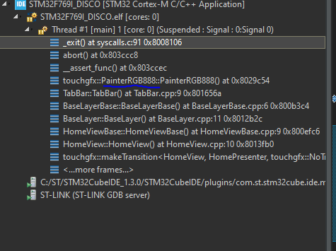

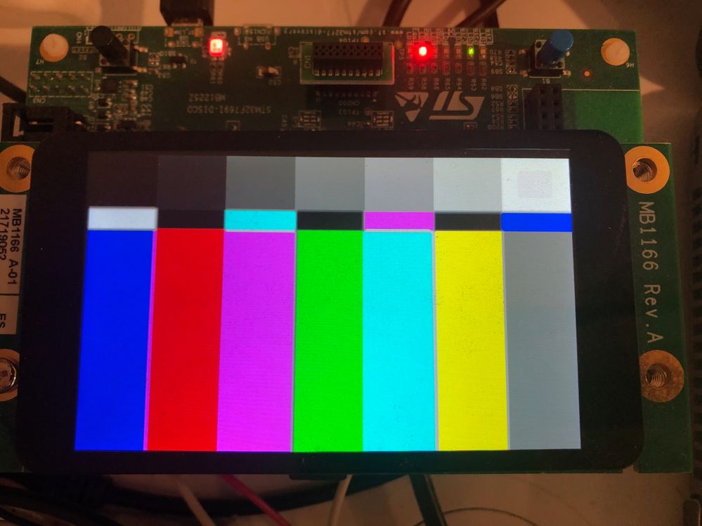

I followed this guide to changing the pixel format of an application. Although my TouchGFX designer file does not have the code listed above the framebuffer pixel format table 2/3 of the way down the page, in the Designer itself it reports 16bit color and RGB565. However, when I build and run my application, the screen appears corrupted and then freezes. The stack trace is attached, but it appears that during the constructor call of one of my custom containers, a PainterRGB888 reference is called and an assertion fails(?), hanging the program.
If I make a simple screen that doesn't have that custom container, the display still corrupts though it doesn't seem to crash.

Hi Michael,
One function I think it still needs to be modified: HAL_DSI_EndOfRefreshCallback() to support 16BPP.
I will be helping you regarding as I'm interested in this support case.
With regards,
Badreddine
What I can think of - in HAL_DSI_EndOfRefreshCallback() change:
LTDC_LAYER(&hltdc, 0)->CFBAR = ((uint32_t)currFbBase) + 448 * 3;
LTDC_LAYER(&hltdc, 0)->CFBLR = ((832 * 3) << 16) | ((REAL_WIDTH) * 3 + 3);
LTDC_LAYER(&hltdc, 0)->CFBLR = (((832 * 3) << 16) | ((WIDTH * 3) + 3));
by
LTDC_LAYER(&hltdc, 0)->CFBAR = ((uint32_t)currFbBase) + 448 * 2;
LTDC_LAYER(&hltdc, 0)->CFBLR = ((832 * 2) << 16) | ((REAL_WIDTH) * 2 + 3);
LTDC_LAYER(&hltdc, 0)->CFBLR = (((832 * 2) << 16) | ((WIDTH * 2) + 3));
3 for 3 bytes (24BPP) needs to be changed to 2 for 2 bytes (16BPP)
Here is the procedure:
  1. Change the LTDC configuration in CubeMx to RGB565 - make sure DSI uses RGB565
  2. In additional software change RGB888 to RGB565
  3. Change HAL_DSI_EndOfRefreshCallback() as described above
  4. replace
OTM8009A_Init(OTM8009A_FORMAT_RBG888, LCD_ORIENTATION_LANDSCAPE);
by
OTM8009A_Init(OTM8009A_FORMAT_RBG565, LCD_ORIENTATION_LANDSCAPE);

In addition, I was using a Painter888RGB in one of my customer containers, which was the actual root cause of the particular assertion failure shown in the stack trace in the OP. Replacing it with a Painter565RGB resolved that particular issue.
