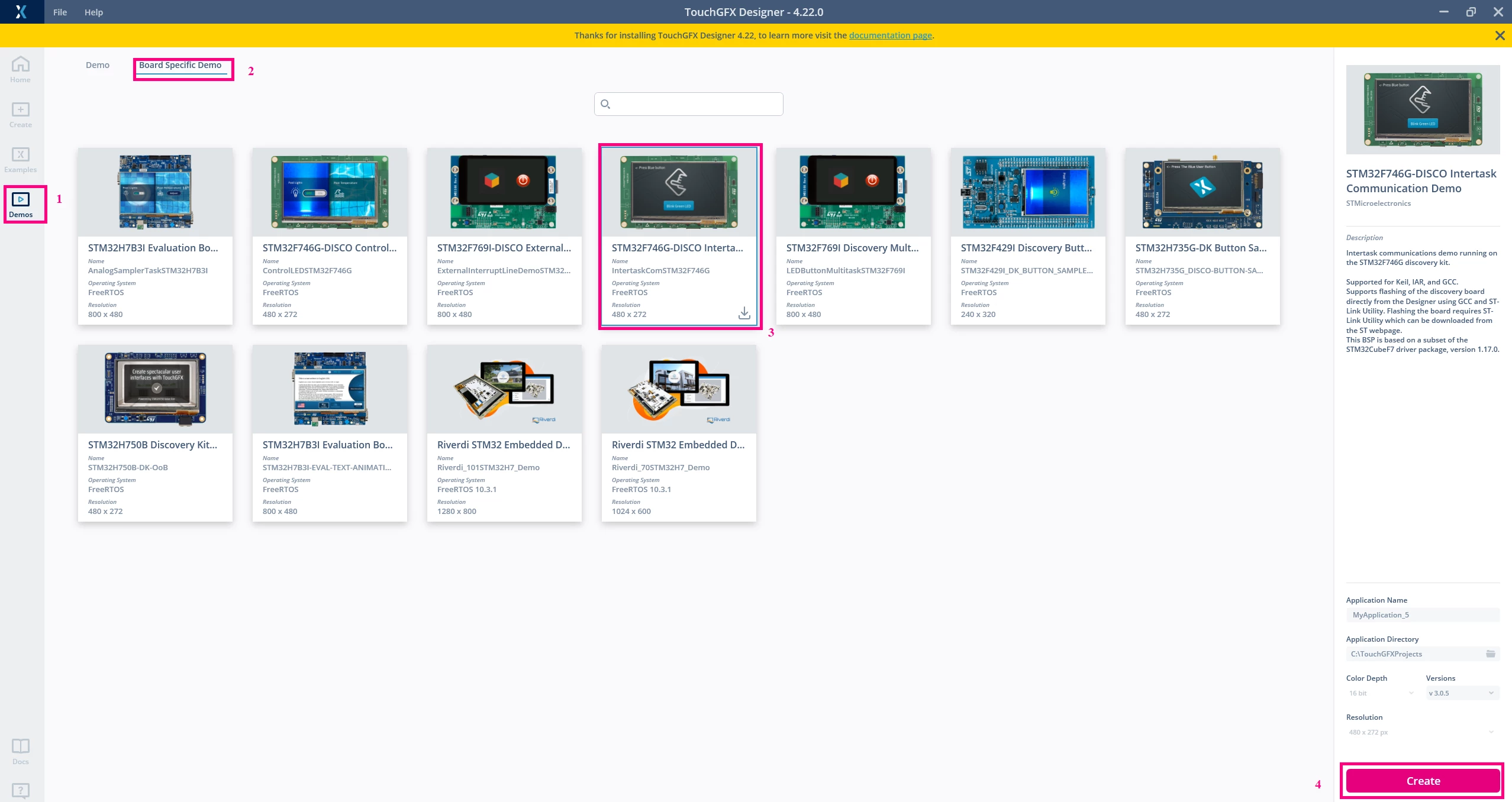

Hi everyone,
reading the official TouchGFX documentation, in the section "Backend Communication->example",
ST people say that there are examples for STM32F746G Discovery Kit that explains in details
how to interact between TouchGFX thread and other threads via intertask communication.
I installed the latest TouchGFX Designer package (4.22.0) where they say that the mentioned
example can be found into folder Demos -> Board Specific Demo, but I have not found it.
Can someone tell me the packages or the tools where I can find those examples?
Thanks in advance to everyone will help me.

Hello @Muscle Man ,
You can find the STM32F746G-DISCO Intertask Communication demo under TouchGFX Designer-4.22.0->Demos-> Board Specific Demo as shown in the below figure:

Thanks a lot!
I thought it was in some subfolders in the installation directory
created when I ran the TouchGFX designer installer.
