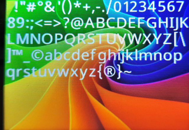

Hi Community,
I'm trying to connect STM32F412 with SPI LCD (ILI9341). And, I'm trying to run TouchGFX on this combination. The white and black color is correct. However, another colors are strange. I think that the endian is swapped. Might be, TouchGFX supports only little endian.
This ILI9341 device only support big-endian at using SPI port. If I use parallel port, it can choose both little-endian and big-endian. However, the target board supports only SPI.
So, I'd like to swap little-endian to big-endian at drawing. Where code do I need to modify?
Please give me your advice. Thank you.

Dec 27, 2021 9:34 PM UTC
ConvHL would work, but it would modify your frame buffer, and you have to convert it back afterwards, which is time consuming and inconvenient.
You should try to leave the byteswapping to the hardware.
The ByteSwap configuration on the ILI9341 display does not work in SPI mode, unfortunately, as stated in the datasheet.
And sometimes you just have to stick to a particular byte order. Say if you are using Chrom-Art (DMA2D) for instance. While just copying a rectangle just works fine, the BS (ByteSwap) bit for DMA2D (if available at all) doesn't do a great job when blending fonts (A4) onto the background (RGB565). (It probably needs an additional bit for that in the future).
Anyway, the next method may help you solve your problem, by just leaving the byte swapping to the hardware, using the next trick.
For this to happen, you can temporarily configure the SPI bus for 16-bit mode, so when you transfer your buffer, the bytes would be send swapped 2-by-2, automatically.

I have tried this for you, using an ILI9341 display, connected to a Nucleo-H7A3ZI-Q development board, and it works fine this way. You now do not have to loose time swapping bytes forth and back.
I added GPIO CS control too, in case you do it by software.
And never forget to set your window for the display.
You now can use DMA2D and nicely blend images.
Hope this helps.
0693W00000Hq9ruQAB.pngPhoto taken using my phone...
