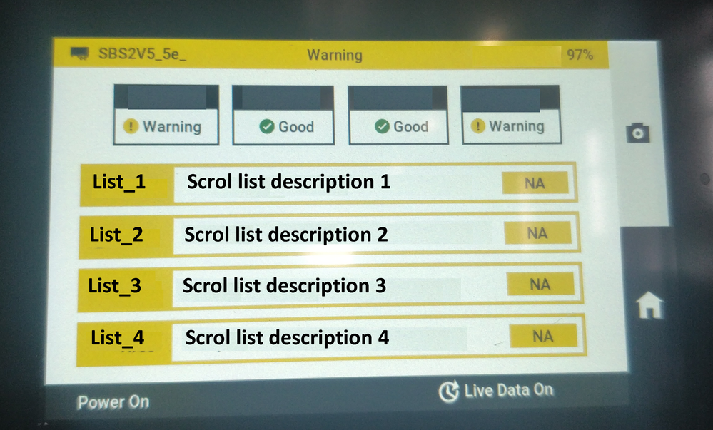

In a touchgfx based UI. I have a scroll list that has more than 5 items for displaying on the screen, but at a time only 4 scroll list items can be displayed on the screen. For reference, I have provided a snapshot of the screen.
0693W00000GXl2nQAD.pngPush-button interfacing is for screen navigation, as it is not a touch-based screen.
How can I scroll the list vertically down so that it can display the other scroll list items?

I do this with push-buttons in my project and here is the short version of how I do this.
I'm using Scrollable Container with custom containers. And my custom container have a flex button and extra text lines.
I use the flexButton.setPressed(true/false) to "highlight" one item at the time when using up/down push buttons.
To scroll items in the Scrollable Container I use scrollableContainer.doScroll(X,Y) (this requires TouchGFX V4.18.0).
GMeur
November 23, 2021
You can do it with the animateToItem() function. In order to do so, you've to retrieve all currently visible items (through the function getItem()) and determine what is the index of the bottommost item. Then you just do animateToItem(bottommost_item + 1).
However, you've to know that the scrollList wasn't really designed to be manipulated that way and I would recommend you to use the scrollContainer instead.
