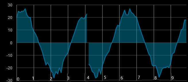

What I want is like this; X-axis label is fixed 0 - 9s ( I draw manually the X-axis by hand, not generated by touchgfx)

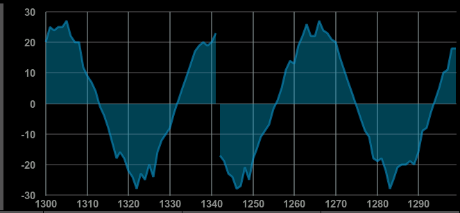

But what Touchgfx gives me is this:
0693W000008ypgaQAA.pngAs we can see from above, X axis label show data point instead of time in seconds and the label grows instead of fixed.

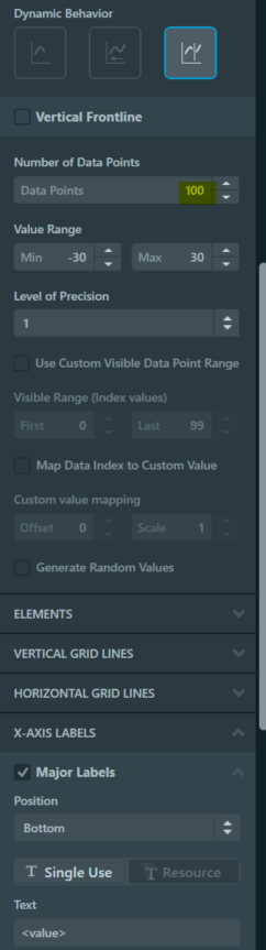

0693W000008yphcQAA.pngMy development board is:

Thank you @MM.22aino​ , however that does not really the intention here. Function setGraphRangeX() is to zoom out part f the graph, but here I still want to display the entire graph (100 points) but with x-axis label fixed 0-9s. So the Y major grid will be in step of 10 points, but instead of showing 0, 10, 20, ...90, I want it to show 0,1,2 ...9. Basically I want my graph to tell user that the X-axis showing data in the span of 10s

Two things to try. Select the graph widget in TouchGFX designer and:
  1. Increase the Level of Precision (under Data Points)
  2. Increase the number of Decimal Points (under X-Axis Labels -> Major Labels)
Edit: just tried it, to fix the zeros you only need to increase the level of precision. Then you can add as many or as few decimals as you want to the x-axis labels.
