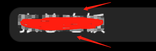

Assuming the height of the drawable object is H (getHeight()), and the height of text is TH (getTextHeight()), how to figure out the correct y value of the text object ??
I tried (getHeight() - text.getTextHeight() - text.getTypedText().getFont->getSpacingAbove()) / 2 and (getHeight() - text.getTextHeight() ) / 2, neither of them is right.

The calculation seems right to me. Can you show me, visually, what's wrong with your calculation?

It is obviously that, the up padding is different from down padding,
and I figure the padding through (getHeight() - text.getTextHeight() - fontSpaceAbove) / 2

Can you debug and verify that the numbers are correct? (text height and spacing above)

The value is wrong !!! value of the getHeight() is 44, while the textHeight() is 34 and the fontspaceabove is 5, thus, the padding is (44-34-5) / 2 = 2, it seems wrong!!!
