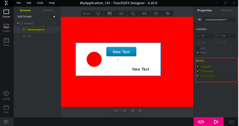

Hi V.H,
Do you mean you want to handle click/drags with your entire container (and not just elements inside it ?)
If yes, you just need to click on your container inside your screen and check the boxes "Draggable", "ClickListener", and "Move Animator" under Mixins in the right panel (Properties).
Then you implements the functions you need when triggered. You can be helped by our article here.
/Osman

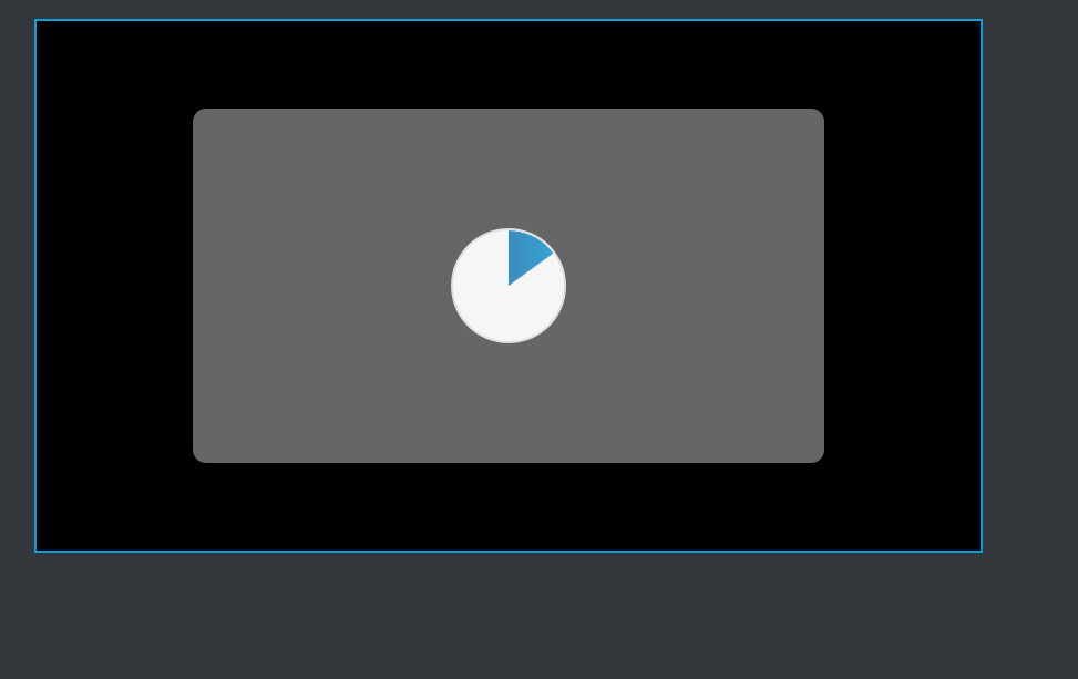

Create a modal window and add a circle progress in it;
1, The widget can be drag when active "Draggable".
2, Generate callback function when click on the widget when active "ClickListener".
But it doesn't meet my needs. I want to used click event to active and up-down gesture event to change value for the circle progress. (The gesture range is greater than the widget range.)
So, I want to used handleClickEvent/handleDragEvent/handleGestureEvent to do it.
