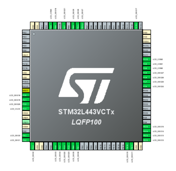

How can we remap STM32L443VCT LCD segment pins to different ports for better layout routing?

Check the datasheet, pinout table, check the ltds pin and signal names, if there are choices... or not. Or change package in case larger pitch ease routing.
SSing.71
Thanks for the reply. But if we look at LQFP100 package, LCD segments pins are not grouped together. They are scattered all four sides of package, which makes routing really difficult.
