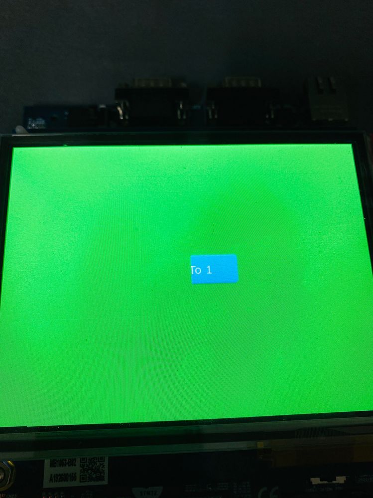

I am developing simple GUI application with 2 screens. each screen has one button with label.
Since the V3 template for this board is not available. I going through the route of creating my own template from CubeMX.
FMC clock = 200MHz
LTDC clock = 25 MHz
I am using external SDRAM with double frambuffer.
location of frambuffer
Frambuffer1 = 0xD0000000
Frambuffer2 = 0xD00E1000

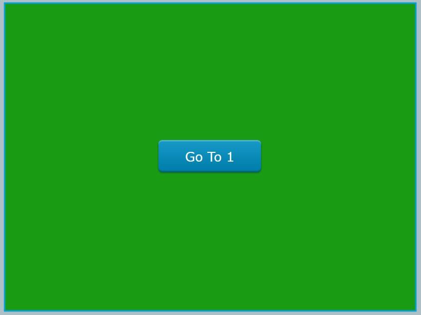

Attached is GUI on my Simulator
If you notice the Button is only shown Half. I even tried with single buffer but same result.
I am attaching my project for reference.

V3 of H743-Eval is up. Check it out!

Thanks Martin. It is working now after comparing with V3 template source code.
