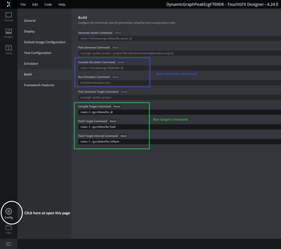

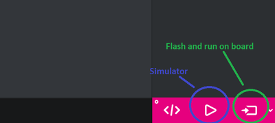

2024-10-01 12:45 AM
Hello @PascalP ,
In TouchGFX Designer, you can either run on simulator or run on target:
Depending on which button you click, you will run different commands:
The Makefile for the simulator is in "projectName\TouchGFX\simulator\gcc".
The Makefile for the board is in "projectName\gcc".
If you modified the simulator Makefile but tried to run on target, it is normal that you still get the error.
If you modified both Makefile and you still have the issue, you should double check how you included the files.
