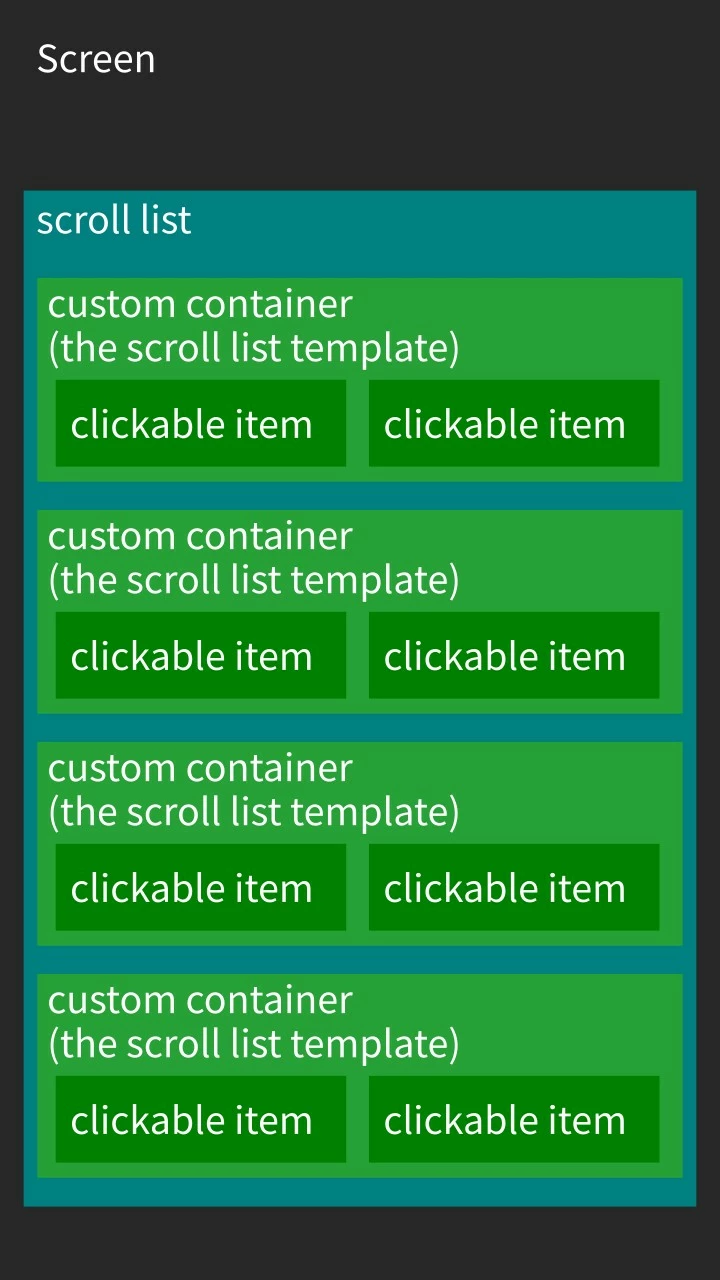

1. I have a scroll list of custom containers which contain several clickable items. Drag events on the scroll list are intercepted by the touch areas of the clickable items. This makes the scroll list difficult to scroll as you have to hit the tiny spaces in between the clickables for the drag event to register.
I saw two posts on this forum regarding a similar problem:
The accepted answers in both of them did not fix my problem as my application does not allow me to override the touch handling on the view level. The answer given by @GMeur in thread 2 was closer to what i was looking for but only works for me when the scroll list template object itself is clickable. In my case only the children of the template object are clickable. As I do not understand when, how and why touch events are propagated from one drawable to its children/parents, I was not able to solve this problem generically (without having to manually wire a ton of touch event callbacks manually for every widget with which I have this issue).

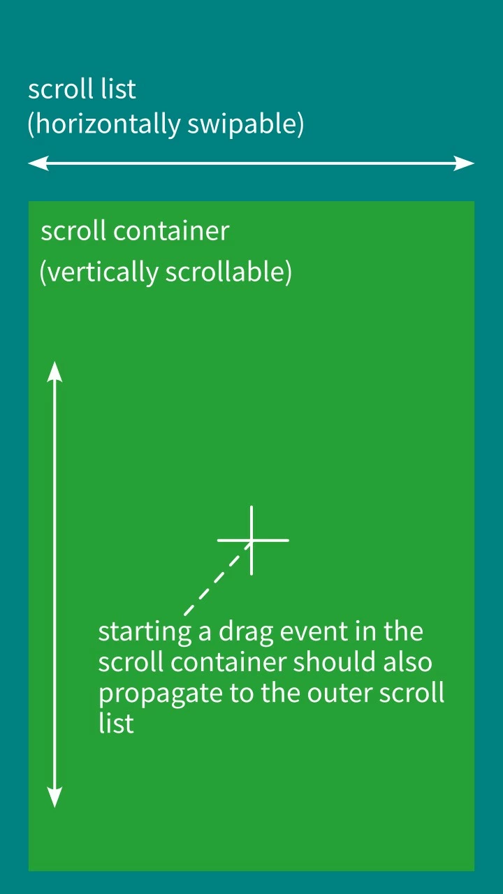

2. I have a horizontally scrolling scroll list which contains a container template with a vertically scrolling scrollable container. I want to be able to swipe the horizontal scroll list even when hitting the touch area of the scrollable container.
This is possible when using two nested scrollable containers but not with scroll list + scroll containers.
  • Where in the event dispatching chain is the event lost/intercepted when using a scroll list?
  • How does the scrollable container implement its touch event handling for it to intercept the touch events regardless of the content of the scrollable container (such as other clickable items like buttons).

The events are propagated to the widget closest to the screen, which would be the leaf in the drawable tree.
To be honest, there is no specific way of dealing with touch events when you have multiple different widgets that need to react in a certain ways to the touch. So, it would be nice to try to design the UI in a way that prevents this issue. However, one solution would be to place a transparent box over your containers and then read the touch from that box to decide if it is a click or a drag, and then propagate that to the required widget.

The difference between the Scroll List and the Scrollable Container is that the Scrollable Container is designed to handle a variety of widgets, while a Scroll List deals only with a specific type. Hence, for the Scrollable Container, the container receives the touch event first and propagates it to the element beneath it. That's why you can click on a button, not release your click, and start a drag in a Scrollable Container. However, such an action is not possible in a Scroll List because the touch event is directed toward the element first.
