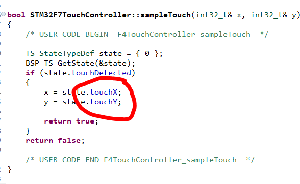

João Costa
Dec 17, 2019 3:46 PM UTC
Hi @YAdan​​ , sorry for my late reply...
Attached is my BSP drivers for my custom board with STM32F7508N MCU and RK043FN66HS-CTG display with gt911 touch driver implemented. The code is still a little messy and needs a cleanup. It's working good for me. You just need to do a little change on sampleTouch function (as on attached image) and include the stm32f7508_discovery_ts.h on STM32F7TouchController.cpp file. I've made some changes on componets code, under BSP files, so a recomend you to use all my BSP drivers...).
Please let me know if it works!

YAdan
Jan 23, 2020 12:19 PM UTC
It all worked fine using the given files.

Sahil Ahmad
Mar 16, 2020 1:46 PM UTC
@YAdan​ @João Filipe Silva Costa​
Thanks guys, finally it is working for me. For me it didn't worked as it is. I need to Toggle reset and int pins as gt911 datasheet timing. Finally it is working now, thanks you for making that complete drivers, which helped me lot​
