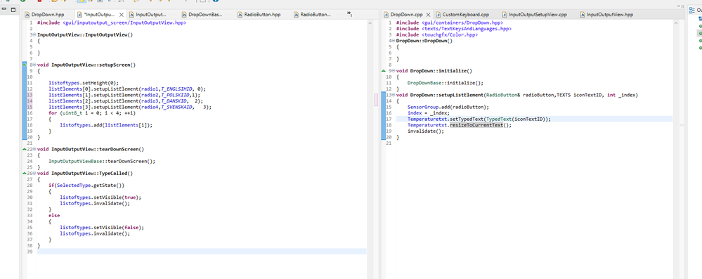

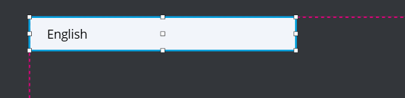

Ok. First of all I create one radio button in custom container:
0693W00000WJQLpQAP.pngThen I write this code in my custom container:
#include <gui/containers/example.hpp>
example::example()
void example::setupListElement(TEXTS iconTextID, int _index)
	index = _index;
	languagetxt.setTypedText(TypedText(iconTextID));
	languagetxt.resizeToCurrentText();
    invalidate();
int example::getIndex()
	return index;

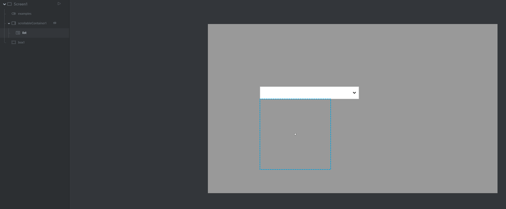

Then I put that container in my screen window: Screen1
0693W00000WJQVGQA5.pngMy Screen1 code looks like that:

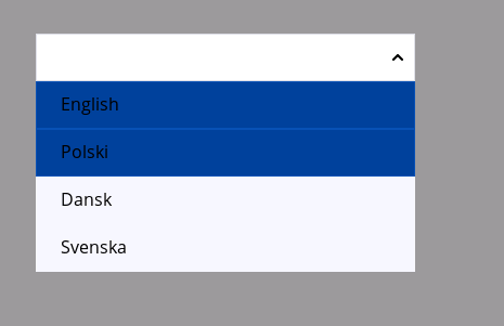

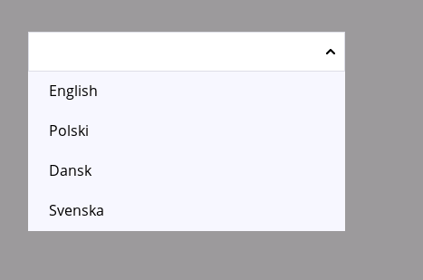

Start simulator and click on toggle button we see dropdown
0693W00000WJQVaQAP.pngIf I click for example english and polski it selects both of them(as usually if all buttons are in one group then if I click one option deselects another and so on).0693W00000WJQYFQA5.png So the question is this how to add all radio buttons in one group programmatically? In this project I use a lot of dropdowns and I need to create them dinammically because it allocate a lot of microprocessor memory.
