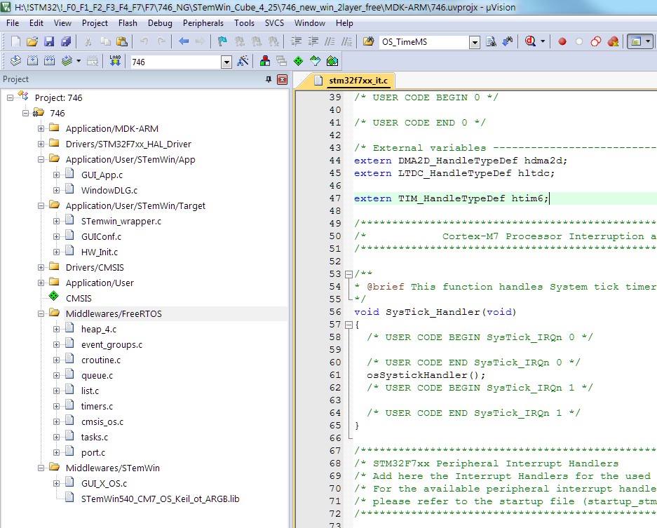

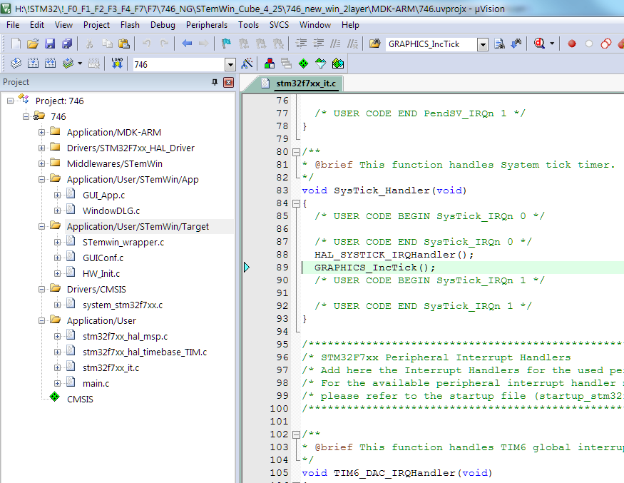

I made a project for CubeMX 4.25 + STemWin with 746Discovery (default config setting from CubeMX).
Everythingis well. (Keil 5.25 compiler)
I add FREERTOS to project (1 task with default setting)
After compiling I have error
linking...
746\7axf: Error: L6218E: Undefined symbol OS_TimeMS (referred from stemwin_wrapper.o).
Searching for 'OS_TimeMS'...
H:\!STM32\!_F0_F1_F2_F3_F4_F7\F7\746_NG\STemWin_Cube_4_25\746_new_win_2layer_free\STemWin\Target\STemwin_wrapper.c(85) : extern volatile GUI_TIMER_TIME OS_TimeMS;
H:\!STM32\!_F0_F1_F2_F3_F4_F7\F7\746_NG\STemWin_Cube_4_25\746_new_win_2layer_free\STemWin\Target\STemwin_wrapper.c(876) : OS_TimeMS++;
Lines matched: 2 Files matched: 1 Total files searched: 148
A similar situation for F4..

Posted on May 24, 2018 at 00:47
Imen,
Thank you for attention.
CubeMX have to add GUI_X_OS.c to project with FREERTOS and delete GUI_X.c from a project
It is my no RTOS project
IT is FREERTOS project
For no RTOS project
H:\!STM32\!_F0_F1_F2_F3_F4_F7\F7\746_NG\STemWin_Cube_4_25\746_new_win_2layer\STemWin\Target\STemwin_wrapper.c(85) : extern volatile GUI_TIMER_TIME OS_TimeMS;
H:\!STM32\!_F0_F1_F2_F3_F4_F7\F7\746_NG\STemWin_Cube_4_25\746_new_win_2layer\STemWin\Target\STemwin_wrapper.c(876) : OS_TimeMS++;
H:\!STM32\!_F0_F1_F2_F3_F4_F7\F7\746_NG\STemWin_Cube_4_25\746_new_win_2layer\Middlewares\ST\STemWin\OS\GUI_X.c(59) : volatile GUI_TIMER_TIME OS_TimeMS;
H:\!STM32\!_F0_F1_F2_F3_F4_F7\F7\746_NG\STemWin_Cube_4_25\746_new_win_2layer\Middlewares\ST\STemWin\OS\GUI_X.c(73) : return OS_TimeMS;
H:\!STM32\!_F0_F1_F2_F3_F4_F7\F7\746_NG\STemWin_Cube_4_25\746_new_win_2layer\Middlewares\ST\STemWin\OS\GUI_X.c(77) : int tEnd = OS_TimeMS + ms;
H:\!STM32\!_F0_F1_F2_F3_F4_F7\F7\746_NG\STemWin_Cube_4_25\746_new_win_2layer\Middlewares\ST\STemWin\OS\GUI_X.c(78) : while ((tEnd - OS_TimeMS) > 0);
Lines matched: 6 Files matched: 2 Total files searched: 120
For FREERTOS project
H:\!STM32\!_F0_F1_F2_F3_F4_F7\F7\746_NG\STemWin_Cube_4_25\746_new_win_2layer_free\STemWin\Target\STemwin_wrapper.c(876) : // OS_TimeMS++;
Probably the OS_TimeMS generated by CubeMX needs to be removed from FREERTOS project?

Posted on May 26, 2018 at 01:19
solution of bug
in file ..........STemWin\Target\STemwin_wrapper.c comment
line (85):
//extern volatile GUI_TIMER_TIME OS_TimeMS;
line (876) :
// OS_TimeMS++;
It is work OK.
OS_TimeMS it is variable from GUI_X.c
You use GUI_X_OS.c
In attach working example
