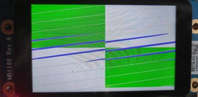

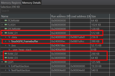

I have a STM32H747I-DISCO touchGFX project that has a 8-bit color depth and it is working very well, when I use external RAM for frame buffer. But when I disable external RAM and use internal RAM for the frame buffer by applying these instructions in the link below, I see partly corrupted screen.
Ref:https://support.touchgfx.com/docs/development/board-bring-up/how-to/03-display-internal
and this is the original screen:
Should I do something else that is not written in the 'Display with framebuffer in internal RAM' instruction?
Thanks for the answers

Hello again,
Do you have any suggestion for this?
MMenz.1
January 10, 2024
Your controller has multiple internal RAM blocks. Can you try anther one? Looks like an alignment problem
GökhanAuthor
January 10, 2024
@MMenz.1 Thank you for your reply but I can not use other RAM blocks because of frame buffer size. What do you mean with alignment problem? Can you explain? Thanks!
MMenz.1
January 10, 2024
DMA often can only access 32bit aligned addresses. When your buffer starts at another address it may lead to shredded images.

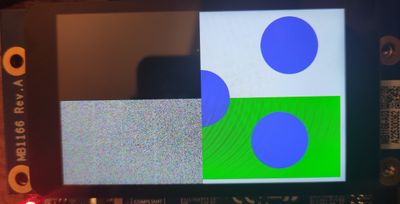

GökhanAuthor
January 10, 2024

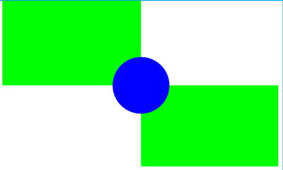

By the way, this is another example.
MMenz.1
January 10, 2024
Are you sure that you have only changed the location of the buffer? it locks a bit like your array dimensions are incorrect. I find it easier to identify when you place small squares with different colors in each corner.

@MMenz.1 I just set frame buffer in internal RAM in a specific address (0x240000EC) and also disabled DMA2D. Can 'Disabling the DMA2D' be the reason? If yes, I had disabled the DMA2D, when I used external RAM and it was working without any problem. Should I enable it, when I use internal RAM.
MMenz.1
January 11, 2024
RAM Address appears to be fine. You could try an even more even address such as 0x24010000.
Why did you disable the DMA2D? Performance is much worse when you do that. Definitely try to enable it. It alone should not break your application however.

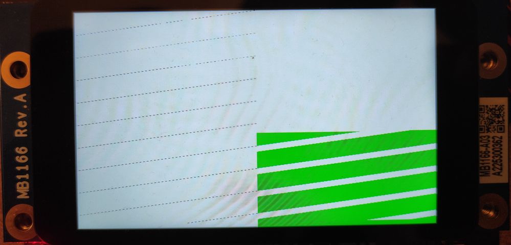

GökhanAuthor
January 10, 2024
One more update... It seems the problem is not about frame buffer. I connected to the MCU with debugger to review frame buffer memory region (in internal RAM). Every byte is in correct place. But I found something else. When I comment out LCD_SetUpdateRegionLeft() in HAL_DSI_TearingEffectCallback() (TouchGFXHAL.cpp), half of the screen is working without any problem.

 But when I uncomment it, screen is not working. Here is the result images:

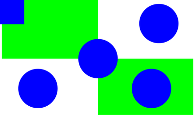

Original image (from touchGFX designer):

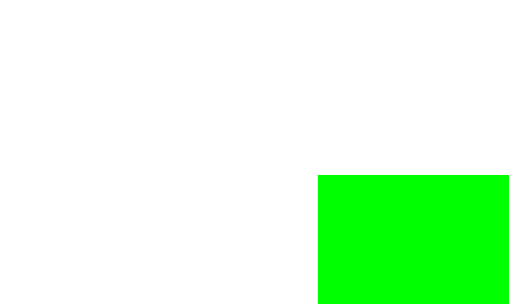

When I comment out LCD_SetUpdateRegionLeft(), right side of the screen is working without any problem:

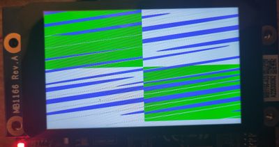

When I uncomment LCD_SetUpdateRegionLeft(), screen is not working. Pixels are not at correct places:
What can be the possible reasons of this situation? I would be grateful if you have any suggestions. Thanks!
MMenz.1
January 11, 2024
you are somehow passing invalid dimensions of the array to touchGfx. LCD_SetUpdateRegionLeft should update the left side of the screen but it appears that it uses wrong dimensions. Try an image with smaller and more unique shapes (as I said, small squared in the corners with unique colors and maybe more) to identify what goes where.
