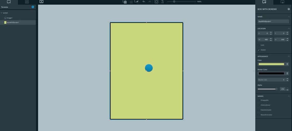

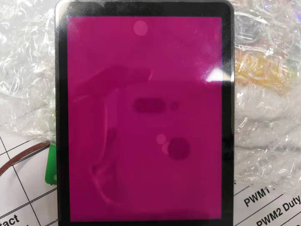

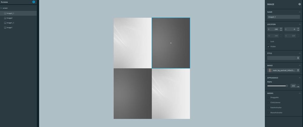

Hi, My project is base on STM32F469 ,LCD use DSI video mode.
Now I can show pixels in TouchGFX box , but can not show images.
Touchgfx project with images:0693W00000AMdJWQA1.jpg
display like this:0693W00000AMcnBQAT.jpg

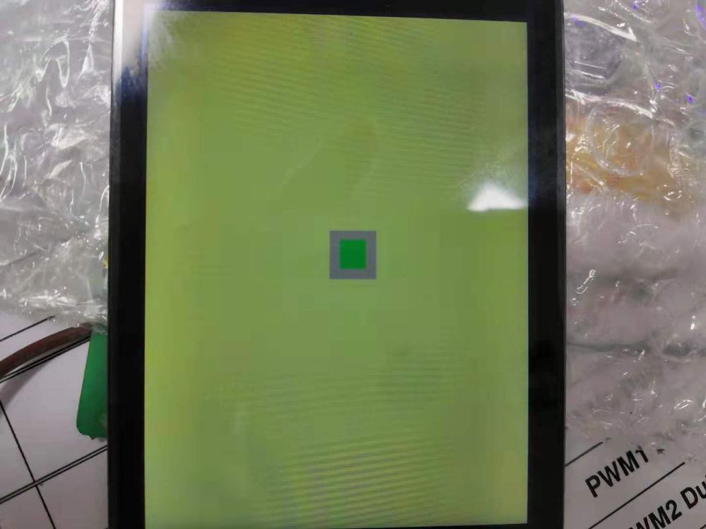

touchgfx project with image&pixel:0693W00000AMdNKQA1.jpg
display like this:
the Images in touchgfx is seted as RGB565.
LCD controller is seted in RGB565 mode.
And DSI,LTDC,LTDC layer,DMA2D both are in RGB565.
Why do I have this effect?How can I fix it?

Thanks everone. I found that qspiflash download FLM is not correct.When I erase flash it write 0x88 into it and touchgfx images always get 0x88...​
And my QSPI memory mapping mode is not setting correctly too.STM32F469-DISCO is use N25Q128A , my project is use W25Q128FV instead.

I had checked my driver and DSI , LTDC setting, is okay.Use HAL_SDRAM_Read_16b() to write Touchgfx image generated xxxbpp.cpp can get correct display.But image in touchgfx project cannot display correctly.

It can show images in internal ways!! I had tested read and write in SDRAM driver and QSPI flsh driver,its ok. Why cant I show images,if they are in qspiflash?Does Touchgfx have some interface for sdram or qspiflash?

I found that I can show images by storage images in internal flash way.Read and write in QSPI memory mapping mode might casue this.Let me check it.:grinning_face_with_sweat:
Zbobo.1
